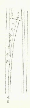

OK, lets see if I can explain this. I can't take anything directly out of the Terzoula book as that would be reprinting without his persmission and would voilate his property rights. But I can pass the jist of it.
I did two quick sketches. Forgive the artwork, I am known for my knives not my drawing skills :D.
In the drawing labeled lock 1, we have the ideal locking liner. This is much like Cliff first stated. A butterknife, reguardless of thickness is very hard to bend when pressed end to end. Or you can think of it like the old stick in the sliding glass door trick. The potential energy of A (knife trying to close) is transferred down the lockbar to B in a nearly straight line. The only energy that would be lost is at the small bend at C. This loss is contained by the handle scale.
In the drawing Lock 2, you have a bowed lock bar. Energy enters A but is now spread all along a mass array of C area. This would be like pushing on that same butterknife if it was already bent. And unlike in lock 1 you do not have the scale to support any possible flex. So you have basically replaced the lock with a leaf spring. This was already proven out by the reviewers comment that there was play and flex in the lockup when pushed.
Please note that as I said before, this is nothing agaist Busse, SWKW or the Rat Trap as a whole. This very well could be a one time problem. Just be sure and keep a watch out for it if you decide to buy this knife.

R.W., thanks for the artwork, that was exactly the sentiment I was trying to convey, but couldn't really express myself. Every linerlock I own looks like Diagram A. I'm a visual learner, so the butter knife analogy just didn't work for me. " Forgive my drawing skills I'm known for my knives not my drawings", actually for those of us who are Engineeringly challenged those drawings are ideal, conveying a relatively complex concept in the simplest possible manner.

That is what I thought you meant the first one, none of my locks look like that. In the picture you can clearly put your finger on the exact spot where it bends.
I just took a Maxx and pushed the lock all the way over so I could see the frame in full bend. Even then you can't tell where the bend actually runs in the frame it is so gradual. Same as in the Rat liner in the above, the first half a dozen or so of the "teeth" are almost in a straight line and then there is an arc.
The shorter the arc the easier it would be to bend the liner by pressing down on it because it will focus the stress in that area. If you take it to an extreme, which is an arc with no radius, i.e. a point bend through an angle, the strength is almost nothing because you have just moved from a compressive bend to a side torque which are not even in the same league in regards to resisting movement.
I think the whols strength issue is a side point though, because I have actually seen no liner breaks reported. The main issue is one of the mating surfaces and how stable the join there and how easy it is to transfer torques to side loads on the locks. Some liners do this very easy, some resist it extremely well.

The weakness of a bow can also be offset by thicker liners. Thicker liners mean that it takes more force to bend the lock bar therefor the bow is less and less an issue.
Also due to the very nature of a liner or frame lock, this should not cause any catastrophic failure of the lock. Unlike a button lock, lock back, axis lock or other similar systems where lock failure is sudden and catastrophic, this type of failure in a liner lock is slow and is easy to spot. The lock will just slowly bend. You can generally catch it and get it fixed long before it really becomes any real threat to safety.
Lock face engagement is the safetly issue on a liner lock and the Rat Trap seems to have way more then enough of that.

Yes, but even with thin liners, this doesn't seem to be the issue. It isn't the liner bending but actually coming off of the tang that causes problems.
Some are really unstable in that you can give them a light pop and they just disengage, some are stable to impacts but move readily with torques, some require really heavy torques.
I have never an integral or liner that didn't torque disengage. Joe however described some customs awhile back that were stable in this regard, they were even light gentlemens folders, so it isn't a size/thickness issue.
Of course on the better ones, the torques are significant and you are starting to move past cutting, certaintly light cutting and into leverage / prying type work.
