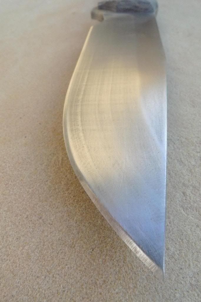

I did some sanding on the Rat and got the marks out. Used 100 grip wrapped around a flat file and took about 20 minutes.

I'm with Turbo on this one.... Those close up pics are nice.... Love that wave on the blade.
But gotta admit, great job:thumbup:
Kjd2121. You are getting there , how many hours of sanding so far ? Jake
The last photos above are after 20 minutes with a flat file wrapped in 100 grit. Didn't take long. I have gone further and removed the longitudinal grind marks on both sides and that was another 30 minutes. I will post more photos later this week.
