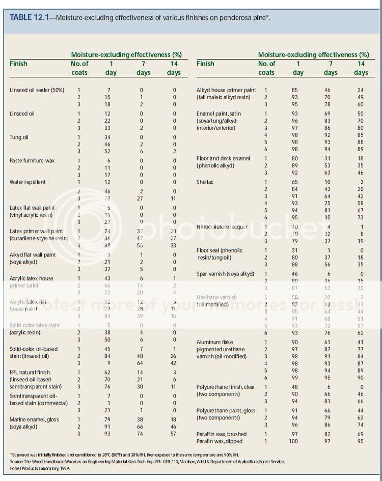

And a pleasing look wouldn't hurt. :) But I don't think I will find a product that does everything. If you are concerned with moisture (big priority for me) this table may be of some help.

Thanks for the table. dipped paraffin wax seems to be excellent and isn't that just what modern candles are made of and this easy to get and cheap and most likely very safe.
Only problem might be that it rubs off when being used more than thinner oils which penetrate the wood deeper.
Or maybe not if it was hot enough and soaked for a long time?
How hot can one go on a wood handle before damaging it?
