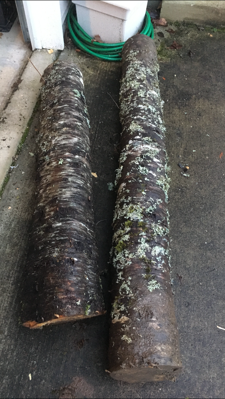

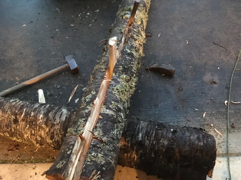

I’m looking for a little input from members who have riven/split out staves for tool handles from fresh wood to finished handles.
What I currently have:
1. Fresh Cherry logs at about 4.5’ and 6’ lengths split into quarters.

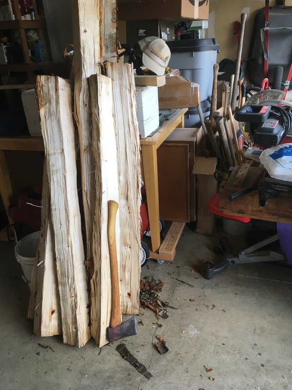

*28” Boys axe for reference.
I won’t have time to get to real green shaping but I would like to hog them down and set them properly to dry for future projects.
My initial questions:
1. Should I cut the 6’ in half?
2. Do I remove the bark now?
3. Should I trim up the ends to below any checking/splits?
4. What do you guys paint the ends with to minimize checking during storage and curing?
5. Should I take them down to thick blanks relatively handle-sized before storage?
Tricks and tips are welcome.
1. Depends on what you are going to do with it. /I would not bother if it is just going to sit and dry.
2. I do. It dries faster and is easier to remove green.
3. Yes, so they do not travel. Ideally I split and cover the ends before checking starts.
4. I use wax.
5.Yes, green carving is much easier.
That is my opinion, I make a lot of utensils and other wood objects/decorations. I am sure the cat can be skinned several ways.

I use Elmers glue to seal so I think a thick coat of almost anything will work. If the sap is running in your climate the bark will peel off easily. If you don't take the bark off it will do just as nature intended and prevent moisture from escaping. Maybe that is better, but it hasn't worked well for me in the spring and summer. The problem with spring cut wood is it can warp really bad.
I will usually pull the bark, seal the ends and then tie wire the staves back together just the way they were split using some scrap wood as spacers, top, bottom and middle.
I am not in your environment though and don't really know what you have. With fall and winter cut wood I can just split it and seal the ends, no worry's at all.
I cut my staves when the sap is down, and leave them 3 or 4 inches longer on average than the finished handle to allow checking to be removed from each end. I don't seal the ends any longer because I have only minor checking from the way I dry my wood.
I also leave the bark on to slow the moisture release.

Checking is caused by differential drying/shrinking. Coats the end. I've seen thinned Elmer's glue recommended several times. Any paint will do. I use whatever rattle can I have handy.
I would remove the bark. Leaving it could lead to warping.
5. I've done it both ways and it didn't make much difference. I suggest carving at least one of them green. See how it goes. Forum member G-pig has done several green with good results, minimal shrinkage or checking. And it carves so much easier green.
Lots of good advice here. Controlling the drying process is tough when you live somewhere that is bone dry indoors during the winter. Patience is definitely a virtue and the old saw about air drying is to allow 1 inch thickness per year. I had some luck 10 years ago with bagging rough shaped fresh wood pieces in drycleaner bags. These are made of super thin clear plastic which breathes enough that differential drying is moderated. 'Buttering' the ends with wax or left over paint doesn't do any harm either.

Red Fury, it could be something else I guess. What strikes you when you see it - bark, color, heartwood (or lack thereof) to sapwood?
An id here reminded me that there is red scat with pits in it along the trail-uphill and downhill from the three trees there each year.

[... it could be something else I guess...
Looks more like some sort of Birch or thereabouts. Cherry should have at least some color in the heartwood. And I understand it has a bit lower moisture than many other woods.
I hate to enlist you guys to ID wood but would closer pics help?
Also, I'm ok if it isn't handle worthy - thought it was fortuitous to be right here.
