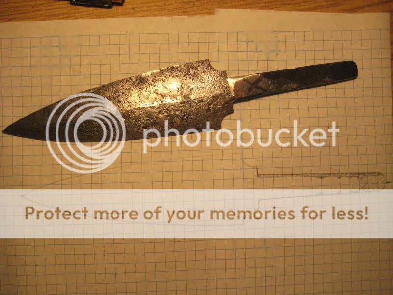

So, here's the first of what probably will be many pictures. I'm still undecided on what to do about the handle, but I will start first in getting everything square and get my centerlines scribed in order to find out where the edge will be.
Don't hold your breath on this thread. I will try to make it enjoyable for you though:)
How come the center looks off center?
this blank I believe was in Ray's box o blanks, and that is probably the reason. This is something that I've already started to figure out how to fix, if you look at my preliminary drawing there you'll see how I might go about it. Gonna be a lot of filing in my future.
I'm thinking that for this knife I will use some 1/8" stock of some kind of material for a double guard, and a steel ferrule.

the first task will be to file away at the tang until it fulfills my fastidiousness:).
The only filing that I will be doing to this knife will be the tang mod pictured above, and the edge bevels. Ray's forging is amazingly accurate-even if the tang isn't exactly centered, the centerline of the primary bevels is super accurate.
