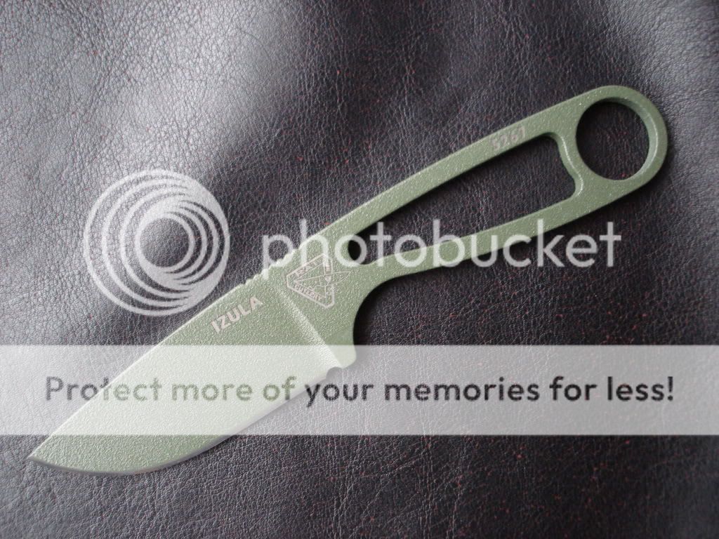

Not sure about doing the whole knife, but if you just want to clean up the blade I did it with my Izula.
Started with this...
I layed sandpaper on a flat peice of wood and drug the blade srtaight down (edge trailing) along the paper. Started with about 120 grit and worked all the way up to 2000, then finished on a strop. This is the result....
Took a few hours to do it, which isn't too bad for me since I work kinda slow. :) There are a few scratches still visible, but I probably could have worked them out if I cared to try hard enough. As you can see though, the blade is still quite mirror like, and I think the knife slices much better than before.
