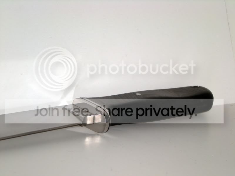

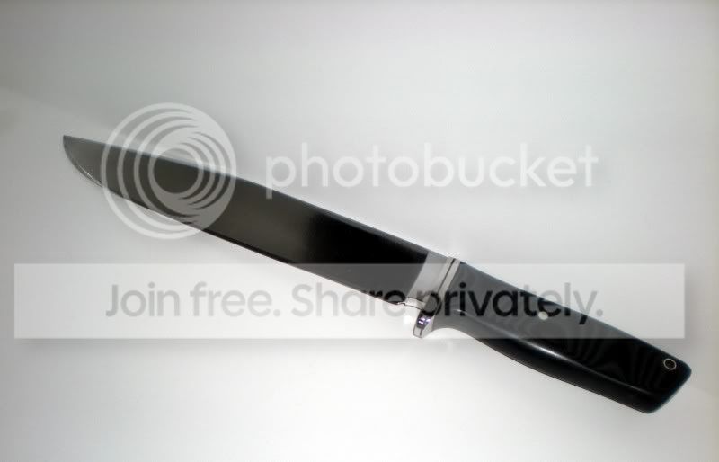

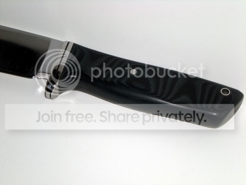

I redid one for a guy. It turned out fairly well I think...
Wow Eric, that looks freakin beautiful bro! In you oppinion do you think the re-gripping is worth it on that knife?
Well, not sure how much he paid for the knife, I traded in goods for my work (a Surefire A2 flashlight), and honestly I made out on the deal. I even made a new sheath for it because I felt I had overcharged him. The hardest part for me was redoing the guard, the factory one was crap. I would say I invested about $80 to $100 in parts and labor (more on the labor side) for the whole project. If you did it yourself, you could do it for about $30 to $50 in supplies / tools, the rest is just sweat. Sorry for the rant, but it was a sweet looking blade and in my opinion, yes, well worth the trouble to replace the factory crap.

TekSec,your handle came out flawless!I have an old carbon V Trailmaster and a Recon Scout your handle treatment would look sweet on.
Thanks all for the words about the re-handle job I did. I hope the customer is still just as pleased with it :)
