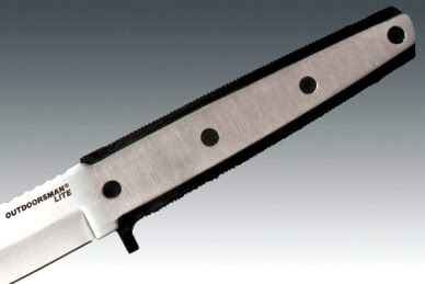

Hi all , just wondering from a curiosity point of view if anyone has attempted to strip the kraton rubber handle from a Cold Steel Outdoorsman , Recon or Tanto style knife and replaced them with another type of handle scales ? Photos would be nice to see ?
I've seen some examples online of some recon scouts with custom handles and was thinking of trying it but the prices on these are a bit high right now to experiment.

Here is the outdoorsman lite tang
Also this

If the tang of the Outdoorsman is the same as the Outdoorsman Lite, it looks like the easiest method for creating a new handle would be to simply add handle scales secured by Chicago screws, no pommel would be necessary. The handle would be a little narrower, as the kraton handle clearly extends beyond the edges of the tang, but if a narrower handle is desirable then that wouldn't be an issue.
Such a task would require only minimal skill, and it wouldn't even require any power tools (although they would make it easier).
All it would take is to choose a handle material that is sold in flat/sheet form (G10, micarta, wood, etc), Trace the tang on the material, including the holes. Drill the holes first for proper alignment (a hand/crank drill could be used), then cut out the shape of the scales with a hacksaw or coping saw (or scroll/band saw), then do final shaping of the edges with a file. If you wanted the sides of the handle to be contoured rather than flat you could use a coarse file for that, then finish by sanding (producing a contoured handle does requires a higher degree of skill).
Then after final sanding of the edges attach the scales with Chicago screws (low profile threaded posts).

Hi Killgar , yeh thanks for the information given . It is actually the Cold Steel Outdoorsman ( San Mai ) knife I am interested in not the Lite version and if I am right in saying I believe the difference is the more robust san mai version has both a steel pommel and a guard which would make fitting a handle a lot harder , probably using scales method depending how wide the tang was ? As you said , an encapsulated tang method . Going to have to look into this more closely .
