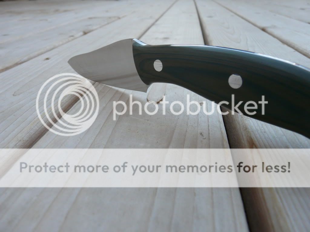

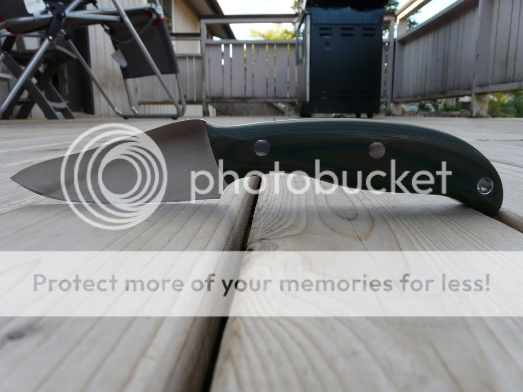

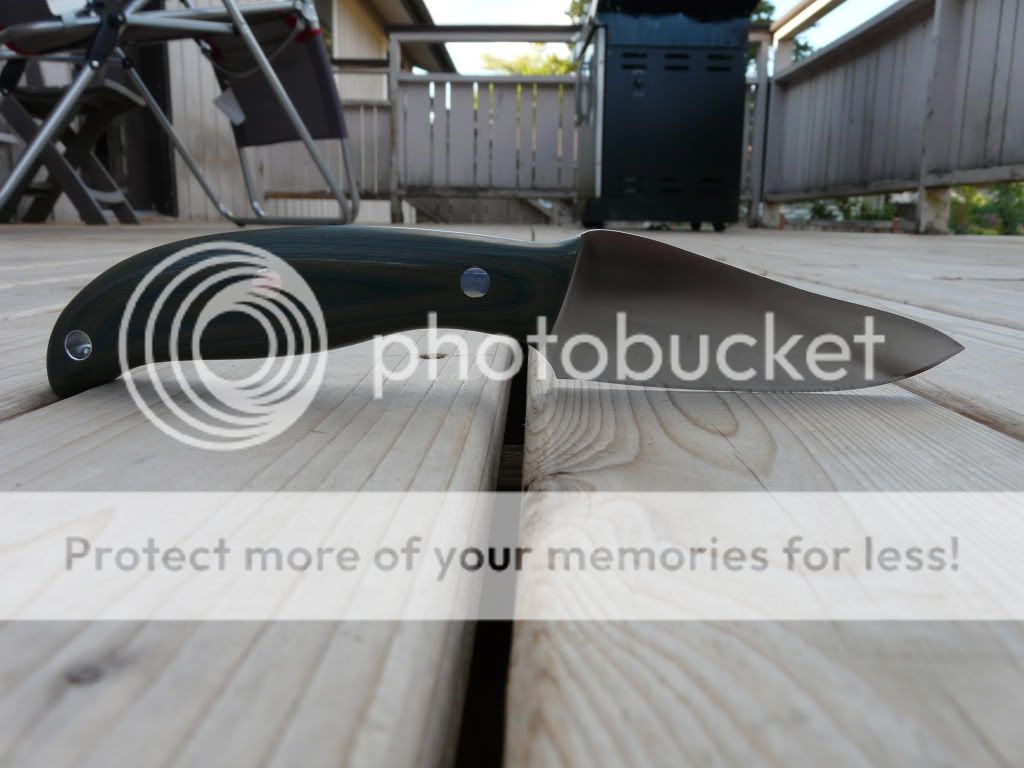

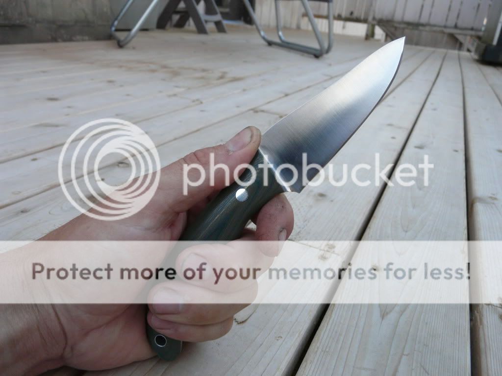

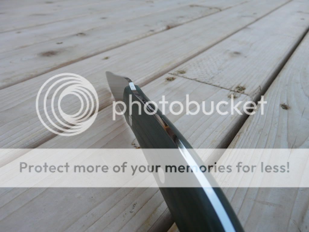

Drop point shape, Multi color G10/ jade, forest, OD Green
A knife for outdoors as well as the kitchen!
Price $110.00 shipped within the U.S., Ill take Paypal if you pay the fees
Kydex sheath Now included for free!!
Full Tang
Handle- 4.4"
Blade- .100x3.4" from front of handle cutting edge is 3.4"
Drop point shape with thumb ramp, full flat grind spine to edge, Convex Edge polished and stropped
Handle material- Buffed G10, G-Flex epoxy with 1/4" aluminum pins and 1/4" aluminum lanyard tube.
blade Steel AEB-L razor steel, Stainless composition like 13c26
Blade Finish is belt finish
Heat Treat in House, plate quench, sub zero freeze, 2 temper cycles
