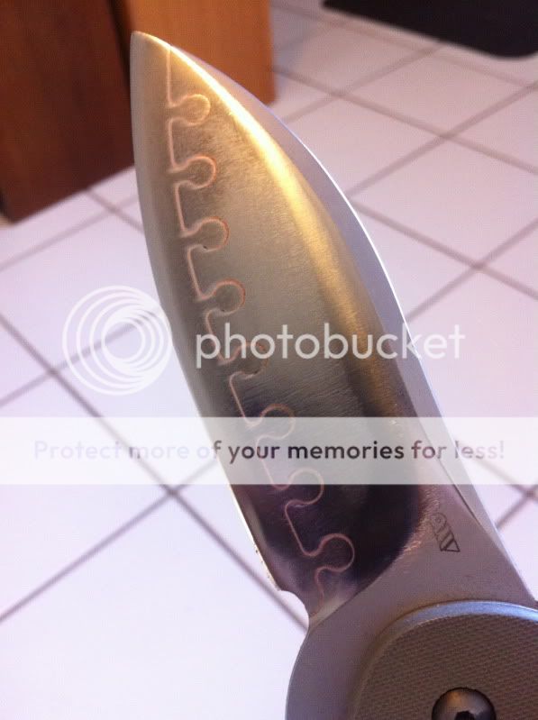

So I guess this would be a true "reprofile"?

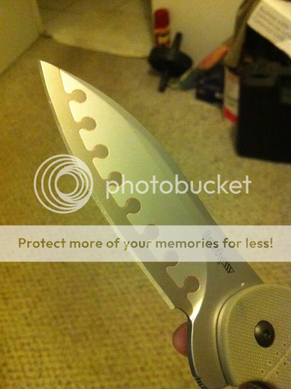

here is a small 're bevel' i did not long ago; doesn't look the best, but its a different cutter now.
factory edge
after
It looks like he did a convex grind. Convex grinds are supposed to cut better because they reduce resistance/drag when cutting through materials.
Actually the idea was to simply thin out the blade behind the edge, but because I used the Worksharp to do it rather than a full size belt sander with a platen(lack of space), it ended up being more convex than the flat ground I would have preferred.
It does cut better though, and I'm hoping to apply the same treatment to a couple of Queen fixed blades to see how that turns out.
