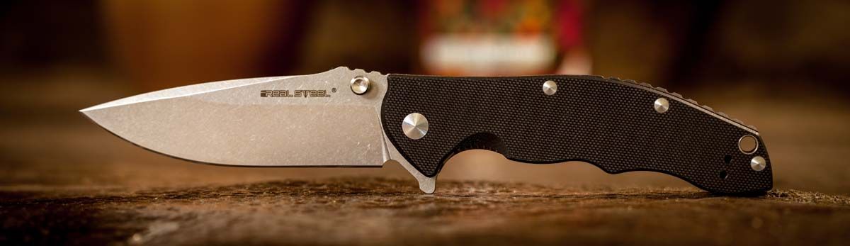

Well just took this shot for now, but it does show off the knife nicely
Thor.jpg~original
If you laid the Sea Eagle atop this one you'd find they almost have the same overall size, length and width, but the Thor is a bit thicker which provides a solid feel when using the knife.
The Sea Eagle has a markedly pointier blade, but also if you laid the blades atop one another you'd see that the Sea Eagle blade's spine comes just about to where the swedge is on the Thor, making them both pretty pointy.
I like the clip on the Sea Eagle a bit better, also the Sea Eagle you are stuck with it's one position, while on the Thor you lefties luck out :) but there isn't any inlay area for the clip to nestle into so you have to rely on the screws keeping the clip in place. I'd prefer just the one side myself, keeping the presentation side more pristine but on the black g10 it's not too noticeable. Speaking of presentation side, I'd shake the hand of the person that laid out how the screws would be, the wrench sides are on the side of the clip leaving a nice looking smooth heads on the presentation side. Something that I'd always do when ever I got a Sebenza, the older Sebenza's that is...
The blade is ground down nice and thin, this one arrived in cutting condition so I'll leave it be for a while before I go to sharpen it.
The blade is also centered nicely in the handle, for those that are concerned about such things, I've only cared if it became a problem otherwise I usually don't check for that.
The flipping action works great, as mentioned before a strong detent provides more than adequate load to light switch an opening, also while this one has thumb studs, I found that it opens equally as fast using the thumb studs too. The front part of the handle looks like it was at first designed to have the thumb stud come up against it as part of the lockup, otherwise it seems odd having that indentation there. Speaking of lockup it is very solid, no play in any direction and unlocking isn't any problem either.
As to the fit and finish, everything is smoothed out, some knives come in with a very sharp edged set of liners, these have their edges knocked down so you don't feel any sharpeness at all there.
I think this will allow my Sea Eagle to go rest in it's nest for a while, I like the handle configuration, not too finger groovy to be a concern that it locks you into one type of grip. I'd recommend this one for any that are on the fence about it, really well done overall.
