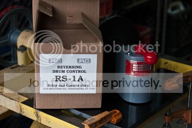

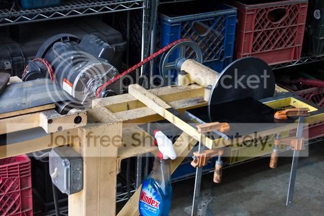

I thought I would try something different today. I've been using my disc grinder more and more, and although it does not have a VFD or anything fancy like that, I want it to reverse. It's about 9:00 am here in the sunshine state. I'm going to update pictures as I go, rather than when I'm done for a real time WIP. Here's the grinder.

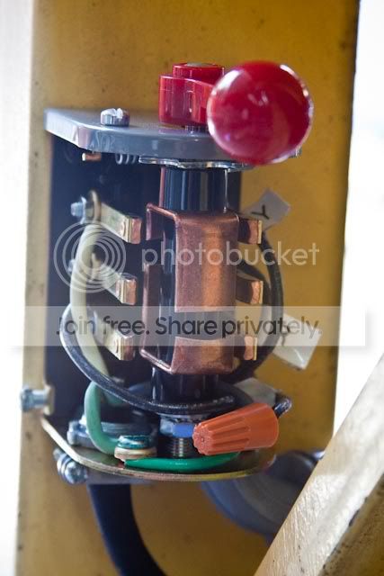

Here's the switch. This switch may be overkill, I've seen it done with a toggle switch mounted on the motor but I could not find reliable directions for that.

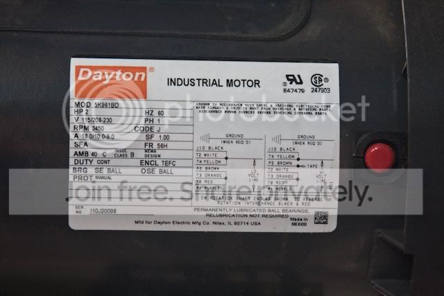

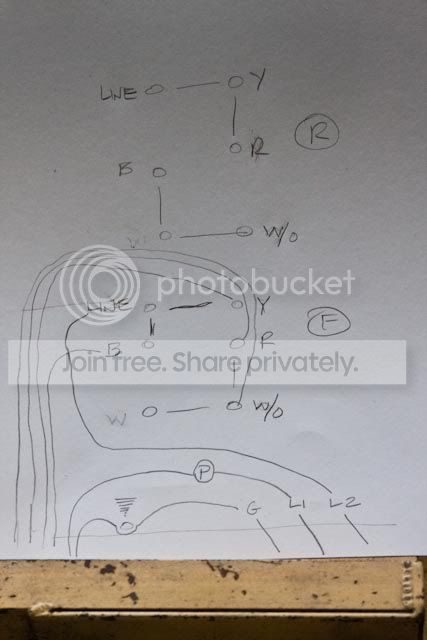

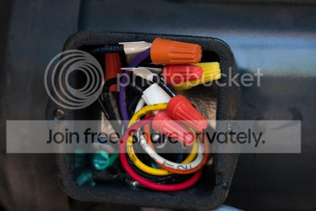

Wiring diagram on the motor.

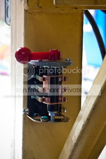

Wiring diagram on the switch.
My wiring diagram to make sense of it.

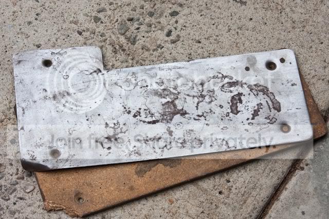

Here's the old tool rest that may also get upgraded today, depends on the UPS man...
It's 9:10 and I need some wire and stuff so I'm off to HD.

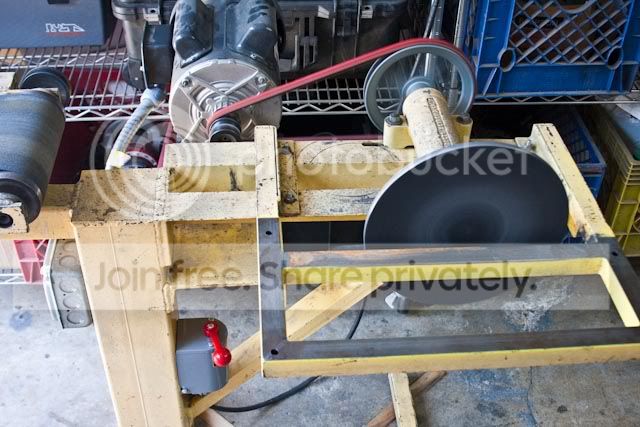

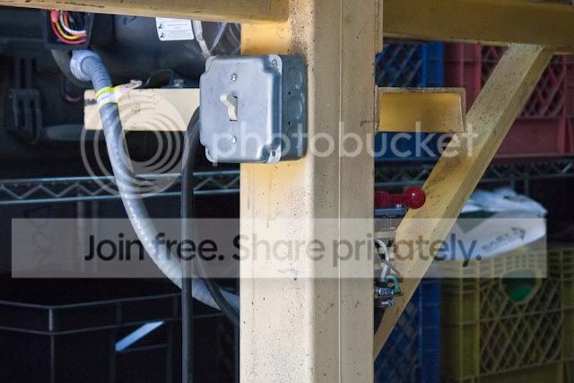

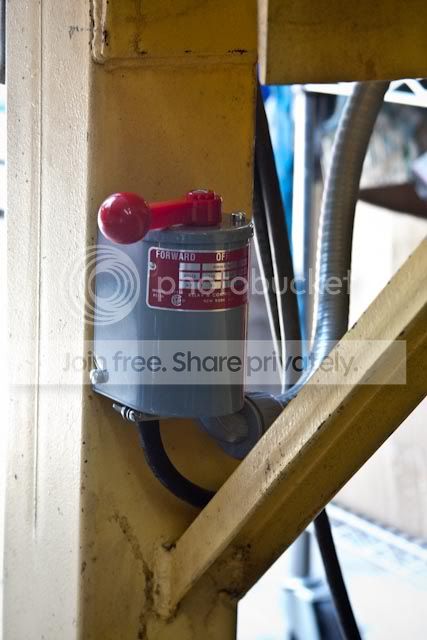

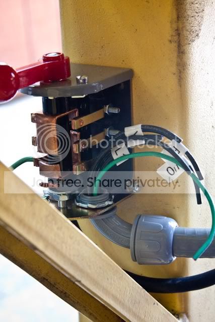

A little over 90 minutes in to it, got back from HD with some wire and fittings, drilled and tapped the column, mounted the switch.

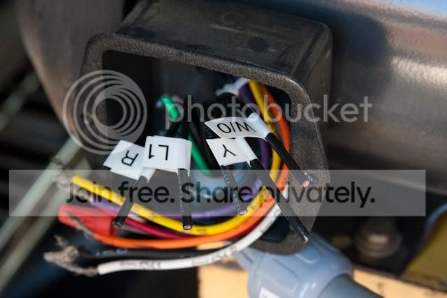

I opened cover open and started pulling wires apart. I decided to edit the original post with a disclaimer:eek:
Watching closely, I have a similarly spec'd motor just waiting to be put to this kind of use. Where did you pick up that switch? I like clear, no confusion type controls on machines, and a big ol' reverse lever like that would be great to quickly see what direction it is in before you turn it on. Is that a center off type switch, BTW?
-Xander
ETA: I just saw the pic of the opened up switch, and I guess it is a center off switch.

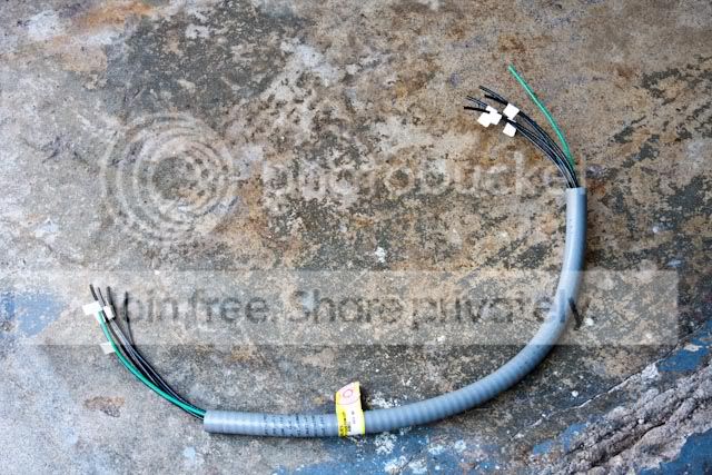

HD didn't have any six-strand 12ga so I ran some 12ga through water tight conduit which I had lying around.
I double checked my wiring diagram, now the hard part, fitting everything in the switch case......
(3 hours into it - I work slow)
Tested, then covers on, then tested again. Works like a champ. Just under 4 hours with a trip to the store. Here's a running picture.

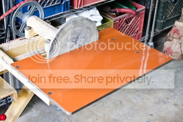

UPS showed up - so she just got a new deck as well. :thumbup:
Sweet! You use blocks for grindng angles? Doesn't look like your deck is a tilting one.
