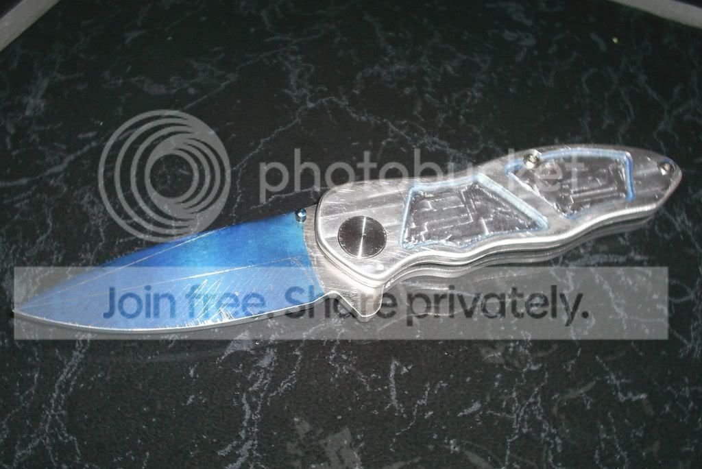

Really need some blade grinding advice guys.
Oct 15, 2007
72
I\'m making a liner lock folder as my first knife. I posted some pictures of it\'s progress about a week ago.I have posted two or three topics on hollow grinding and different blade finishing subjects. I haven\'t found anything that I can really use, other than a couple of very faint pictures. -and that was when I googled \"hollow grinding fixtures\"...
I bought a small low speed wet grinder, for doing finish work. I guess that would prolly be what its best for. It has a fine grain rock, about 1.5 inches wide and about 8 inches in diameter. I have tried free handing the blade on this setup and I cant get anything close to what would be good enough for my standards or anyone else\'s....Every time I touch the blade to the rock, I get a new impression in a different position and location of the last one. I can go ahead and say there is no way I\'m gonna be able to do it free handed. I don\'t want a flat ground edge, because I know that hollow ground would be much better.---Of course I\'m going to rough it in close, heat treat it, and then finish grind it...
I\'m just kind of frustrated, because I have made everything else look really good. I am almost through with everything except for a couple of small details. The handle inserts are done, and really all i need is to grind the blade so that I can fit it in the handles and adjust everything else for a good clearance.
My problem is that the blade has a contour, like most knives do...and I can\'t figure out how to make any sort of fixture to follow that contour. I almost thought I had it figured out on a surface grinder untill I realized that once the blade starts to curve up, I could not follow that traveling in one axis lol. I need some sort of rotary table or some sort of jig...help me out guys....I don\'t want to have to send it to anyone to do it, cause I want to be able to say that I built the whole thing.
I never really new it could get so complex but this knife has 21 parts so far...
I would really apreaciate your hints on how I could go about grinding this blade, because That is really all I need to get the knife finished.
I also want to get the handles anodized, but I don\'t know of anyone who does that. Anybody know where I could get this done and how much it would cost?

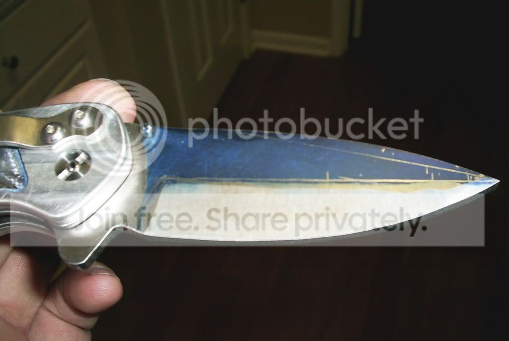

Ok guys here are some updated pics with the progress. as you can see I have blue layout die on the blade. There is a line scribed close to the center of the blade going all the way from the handle to the tip. I want my bevel edge to stop about half way up. I have the rock dimensions listed above in the inital post. If that isn't what I need, What do you all recomend? I guess I also need to grind some tapered angles from the top of the blade down to the point, to establish the point.
I left the wood inserts at work, was gonna bring those and get them in the pictures too, but I forgot. The blade is about .130 thick right now, but it will prolly turn out to be a little under 1/8" when its done after final grinding. The thumb stud is nothing but a cut off drill for now. When I finish the blade I will prolly make one out of two pieces that can screw in and connect from either side of the blade. Everything still looks a little rough, I haven't cleaned up much of it yet to give it the look it will have when its done. I guess I'm making pretty good progress though. Thanks for the help.

I think I might see the problem.
You may not be approaching your grind lines quite right. Generally speaking the grind line is a reflection of edge profile, yours is straight. The main grind should sweep along the tip too, not go straight to the tip. (don't worry, you'll still get that cool line, but that comes later)
The line you have drawn, that goes to the tip, becomes the result where the false edge meets the main bevel. You are trying to stay below that line in your grind, which isn't the way to approach this. Does that make any sense?
The trick to off hand grinding anything is a clear mental picture of the geometry you're trying to get. I think you need to give some thought to what is the real geometry you're going for.
Anyway, you won't need to taper the tip, that will happen as a natural result of the main bevel wrapping around the tip, then adding the false edge.
I agree with the above poster. You are grinding wrong. Your grind line should always follow your blade profile unless you are doing some weird reinforced tip. If your false edge AND main bevel both follow the blade profiles top and bottom, you will end up with a straight line where they meet.
Thank about a normal double ground dagger. Two bevels, top and bottom. If you only ground to the center line on each bevel, you would have no distal taper whatsoever and the thickness of the blade would be the full stock thickness right up to the point.
Thank you for yall's responses. It hit me like a ton of bricks today what yall were saying. I realized I was grinding it wrong and that I should be following the contour of the edge (or where the edge will be). It also hit me that the look that I am looking for, as someone stated above, will eventually come out once the blade is close to being finished, when the false edge meets the other edge.

Well guys I think I've got it. I got both sides done. It took me about 2 and a half hours, but i figured it out. still not perfect, but so close its scary... I'll post some pics in a day or two. right now I'm going to bed..my feet are killing me from standing in the same place that long. once I figured out how, and that I could do it, there was no leaving the grinder for any breaks or anything..lol:D
