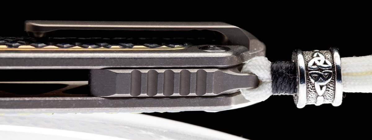

Lanyard/back spacer: Titanium with some jimping and a small hole that you can fit 550 paracord through to make a lanyard, which is nice as it keeps the paracord thickness below the level of the scales, doesn't make a bump.

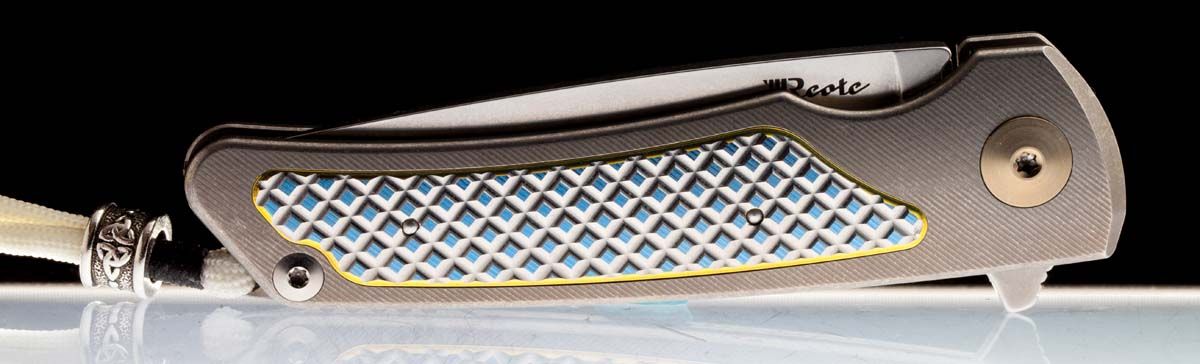

Here are some images taken tonight;
Wave_closed.jpg~original
wave_clipped.jpg~original
Wave_open.jpg~original
Wave_closeup.jpg~original
Wave_angle.jpg~original
Wave_inlay.jpg~original
Wave_lanyard.jpg~original

Good looking knife and good looking pictures! I like how the inlay covers the lock bar. Nice combination of form and function!
Thanks JD, it's a very well thought out knife for sure.

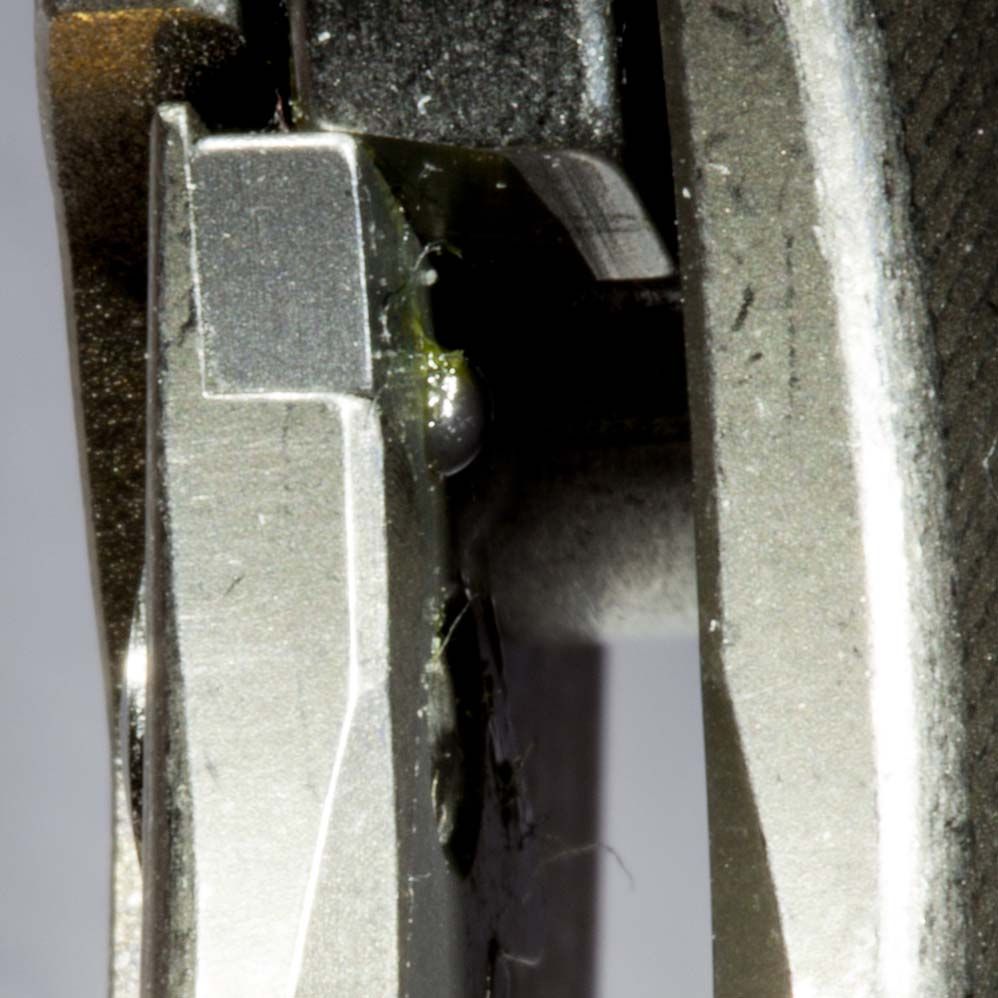

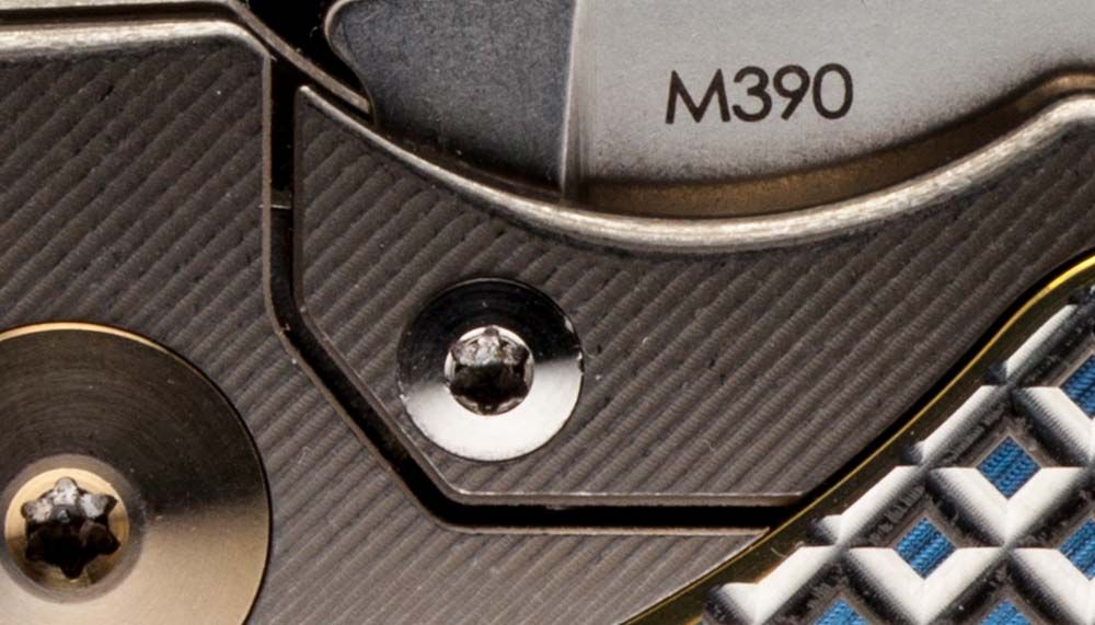

Here's a crop of the side of the lockbar, the steel insert is hidden by the Ti
Wave_lockbar_face.jpg~original
and here you can see how the Ti was cut out to hide the steel insert, on the left you can just see the head of the screw holding that in place.
Wave_lockbar_insert.jpg~original
