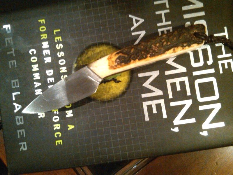

Rolf, Will Leavitt really made a believer outta me in the pocket straight knife department.
They'll never fill the role a folder can completely, but a folder sometimes can't fill the role a straight knife can. Depends on what sort of dude you are, I suppose.
Same here:
