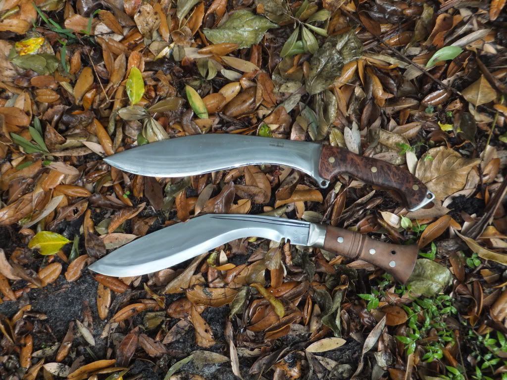

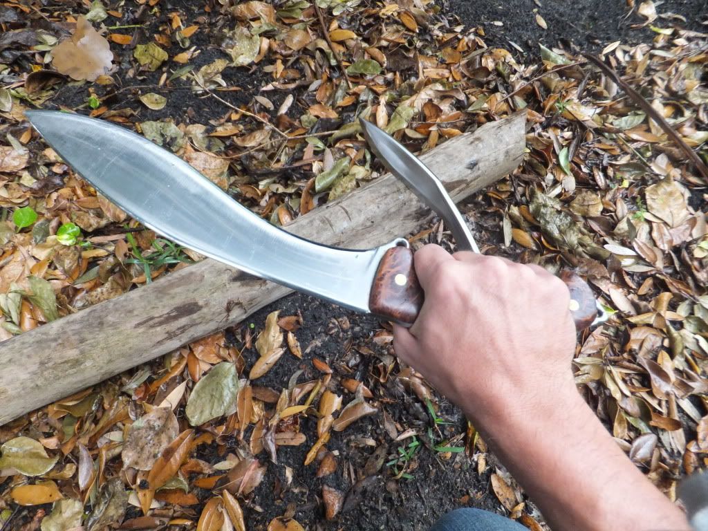

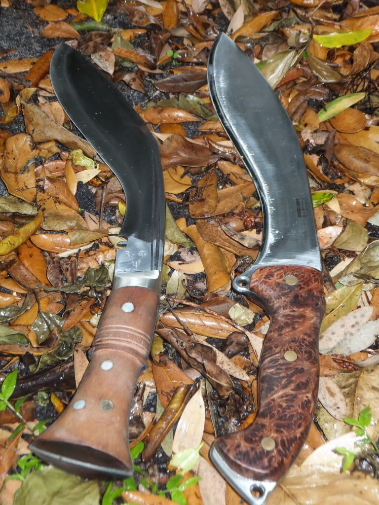

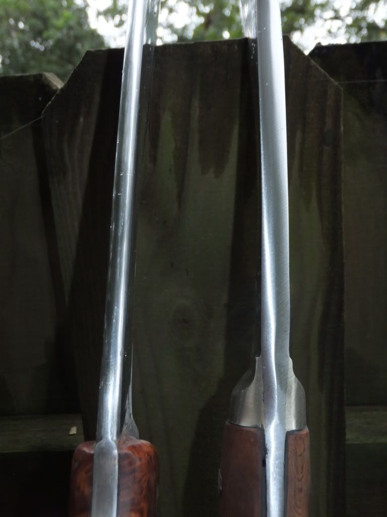

And I'm rather impressed with the ASTK so far, very light and lively and for as rough shape as the handle is in, pretty comfortable. This one was a blem from last week and my first HI of this size ( I have a giant 25 inch Korba). Picked it up from the PO is morning and managed to snap a few pics between downpours today. I have been saving a stunning piece of flamed redwood for a handle this size ( rather wide at the base), can't wait to start this project when I have some time ( any tips about rehandling a HI would be helpful, any hidden surprises?). I was impressed as to how the ASTK performed, I don't know if it's the lighter weight, or the balance point, but it just feels like a different animal than my Busse Zilla

After 20 chops ( pretty hard, old wood, makes a clank noise when you hit it)
Couple spine shots, (the ASTK spine looks tapered, not sure if that's intentional, or was it a hidden tang that was hammered flat?) you can also see where the wood handle has shrunk and pulled away

It's hard to compare the two, they feel very different in hand, before ( and after) I rehandle the ASTK I am going to do an performance comparison between the two. From limited use today, the HI feels quite a bit lighter ( it's about 10 oz or so lighter) and had a tendency to get stuck ( about 5 or 6 times while chopping) from past experience the Zilla does not.
J:
Thanks for the pics and comparisons. You make this comment:
"Couple spine shots, (the ASTK spine looks tapered, not sure if that's intentional, or was it a hidden tang that was hammered flat?)"
I have a recent ASTK very similar to yours, 27 oz with a Satisaal handle instead of Dhar wood. I also have one of the older versions of the ASTK, also about 18", but heavier (37 oz) with a much thicker tang like the tang on your Busse.
The newer, tapered tangs are similar to the tangs on the CAKS (chiruwa-style handles). The somewhat older ASTK thick tang is more an exception for HI. I think the kamis have changed to the standard tapered tang to reduce the overall weight of the ASTK. I'm sure it was intentional.
I have mixed feelings about the change. My 37 oz ASTK with the super-thick tang feels massive in my hand, but very well balanced. The handle is slightly longer (about 1/2"), which helps, but the main difference is that more of the weight is in the tang. I have several HI khukuris of different models and I've found that 37 oz is too heavy for me except for this older-style ASTK. It's a favorite of mine.
On the other hand, I also like the lighter weight of my newer ASTK at 27 oz. It's why I decided to get a second ASTK. Given that the two are the same length, the weight difference is huge. Going from 27 oz to 37 oz is a 36 percent increase. The hand, arm and shoulder can definitely feel the difference.
As far as strength is concerned, I consider the extra thick tang overkill. I like the balance and how it looks, but I certainly wouldn't worry about the strength of the tapered tang, expecially since it is the standard for the super-tough CAKs.

Jroden5446, Thanks for the review mate, the ASTK is on my wish list for this year.
I believe the tapered tang is referred to as 'distal taper' and is intentional.
I've been told that distal taper can improve handling/cutting/thrusting characteristics, balance, weight ratio between tang / blade and strength.

Thanks for the info guys. I'm actually glad it's lighter, it's a nice contrast to my 38oz or so Zilla, but with the same lenght, and still has a nice forward balance that chops pretty darn well
Funny aside, when I first chopped with the ASTK , I hit out closer to the tip, after about 2 chops my hand was killing me, nearly dropped it there and then and said forget it! Tried again a bit closer to the recurve, and no pain and started chewing up the wood, technique does count for something huh!

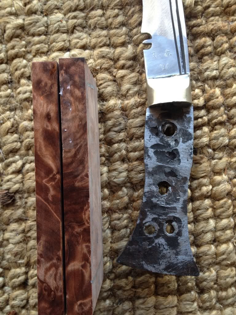

Thanks! Once I rehandle the ASTK with a denser wood ( this is what I have put aside

Will do! I may get started on it this weekend, I'll take some pics of the process and the finished result
I have a 42oz ASTK with one of the earlier thick tangs and I would prefer newer model that's about 28-32oz.
I think that's what threw me, I was reading the announcement post about the new model ASTK and saw it had a thick tang, I actually really like the smaller/ tapered tang
No time like the present! There were a couple of spikes on either side of the tang, they coincided with the ring. Removed them, but let the waistline line profile of the handle

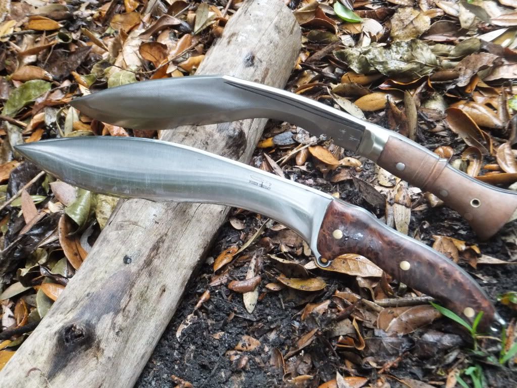

Coming along, have a little more shaping to do, then starts the polishing
I did some leather spaces to help the transition from bolster to wood
