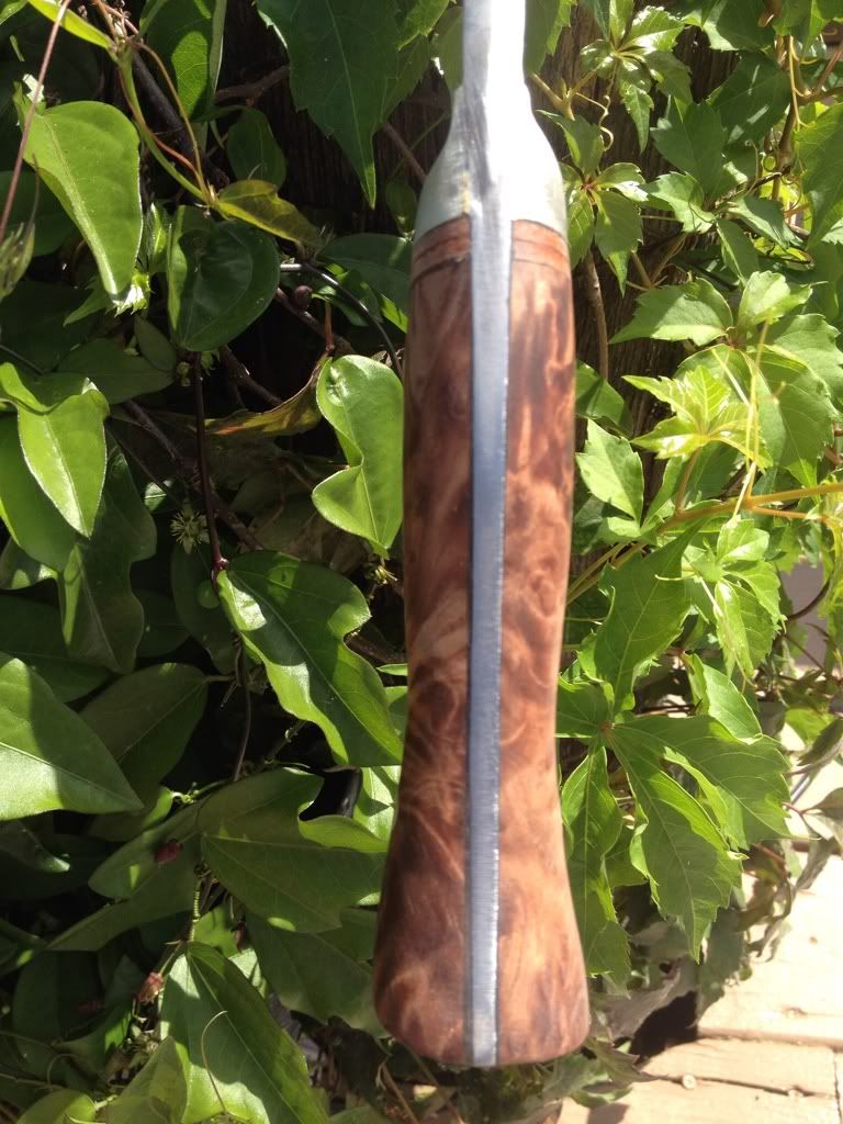

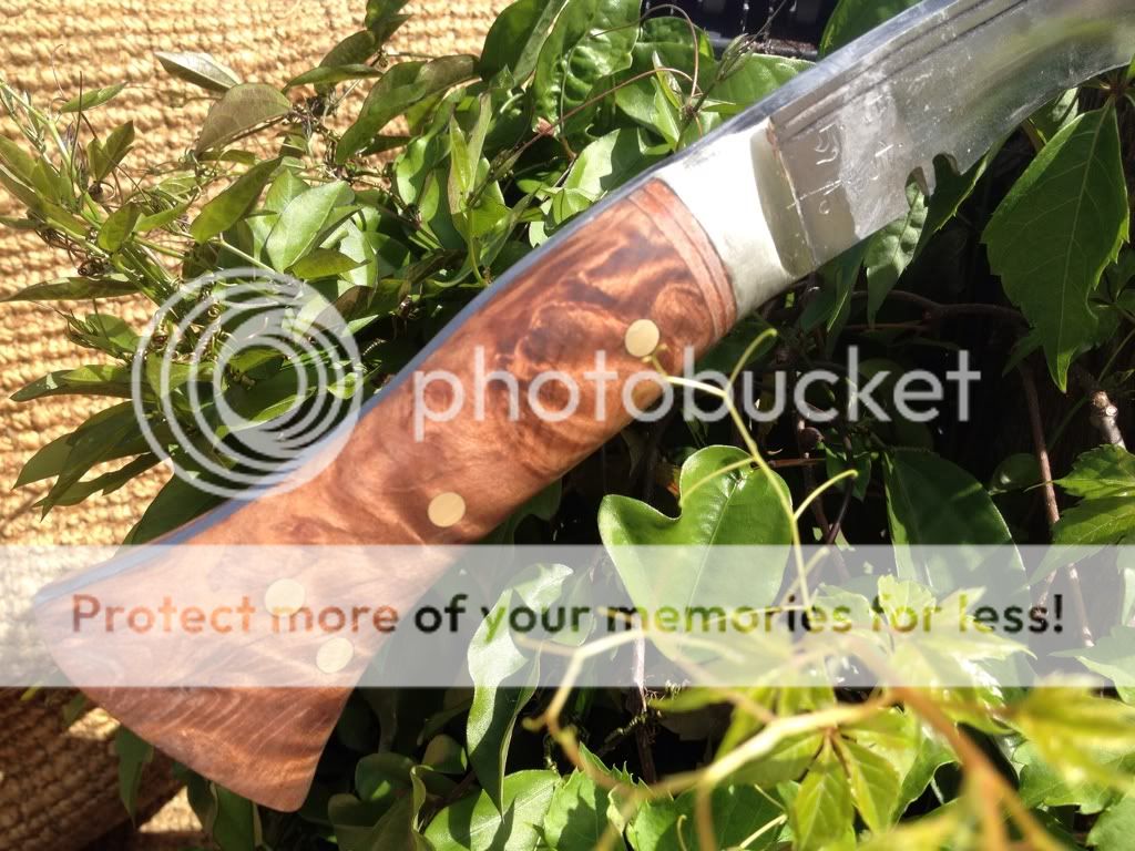

Received an ASTK today...Few pics with my Zilla ( quick update added)

Just finished it up to 400 grit, realized I'm out of everything above that, have to hit the auto store later,
You do good work, and fast! I think I could do something like that, but it would take me a month of evenings.
If you don't mind sharing your secrets:
1. What kind of epoxy did you use?
2. What kind of pins?
3. How did you apply the pins? I always worry that hammering the ends will damage the wood.

No problem man, and thanks
1.) locktite brand 2 part epoxy ( the stuff they sell at Home depot) haven't had any issues with it yet
2.) it's round brass pin stock from jantz supply, it comes in 12 inch lengths, cuts easy with a hacksaw
3.). I just cut them a little longer than I need, mix up some epoxy, get a coat of epoxy on them, just push them in, it's usually a snug fit, but not to tight, then just leave them till the epoxy cures
I'm speechless Jroden! That is absolutely stunning:thumbup:You could easily make some extra $ around here doing this stuff. Do you work in micarta/G10 as well? That wood is just beautiful in every way and your shaping looks incredible. Thanks for posting your work. Take care.
I've got some mesh backed stuff that goes up to 12000 grit. Great work, really gives it a unique and breathtaking look.

Total time was maybe 4 or 5 hours ( that's with waiting on the epoxy to cure to a hard enough state)
