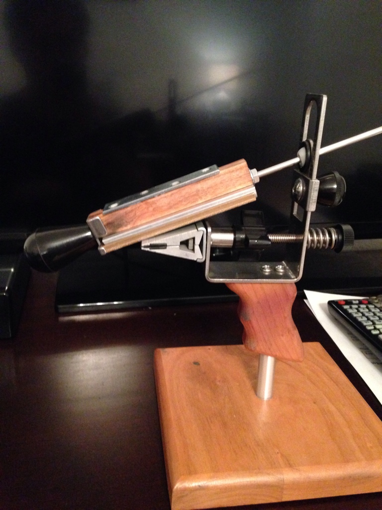

Just as a preliminary so far I love it. They really did resolve all of the issues that I was having with the DMT system. It's much easier to use and is a much much better design IMHO.
Unlike a lot of systems while the vertical bar is marked with specific angles, well it's supposed to be, I haven't actually looked as I use an Angle Cube to set the exact angle I want. That's the really nice thing, it is infinitely adjustable between 17 and 30 degrees. Well that's what the spec calls for, but as it turns out and this is one of the reasons I chose it, all you need to do is turn the rod pivot upside down and you can get down to about 8 degrees. The lowest I'm going is 12 degrees for my Santoku and it works very well at that angle and it looks to have enough room to go lower. Of course this all depends on the width of the knife.
I've only done a couple of knives so far but I love this thing.
And like most things, the more you use something, the more comfortable you get. Allowing you to fine tune, and try out any tips/tricks you may find online.

One of my favorite things is that you don't have to use only preset angles, just add an Angle Cube and you are golden. One thing I'm planning on doing is adding a thin piece of steel to the top of the stone carrier so I can attach the angle cube and make it quick and easy to set the angle.
Ron has told me to be careful adding wieght to the stone holder. Even just a little bit can increase wear on the stones and shorten their life. But congrats, I LOVE this system as well
I have done that and it works great. I used a blade from a feeler gauge that I had in my toolbox.
Yes, the diamond stones work best with very little pressure. The weight of the stone holder itself is usually enough.
The feeler gauge blade is a great idea. I couldn't find anything thin enough so I called by brother and he was going to make me something but I'll keep the feeler gauge in mind, thanks.
I bought a metal screw bracket from Home Depot and gorilla glued it to the stone holder. Another item that is clutch are the two knobs I added to the stone holder and the angle adjustment knob. I owe Dean O on you tube for that one. Way more comfortable on those longer re profile jobs.
Of course I say that but this is what I have on mine. I have just learned to offset the pressure difference.
[/URL][/IMG]
I had the machinist at work mill me 3 of them out of stainless and I polished them in a drill upto 1500 grit and them with a mag polish
