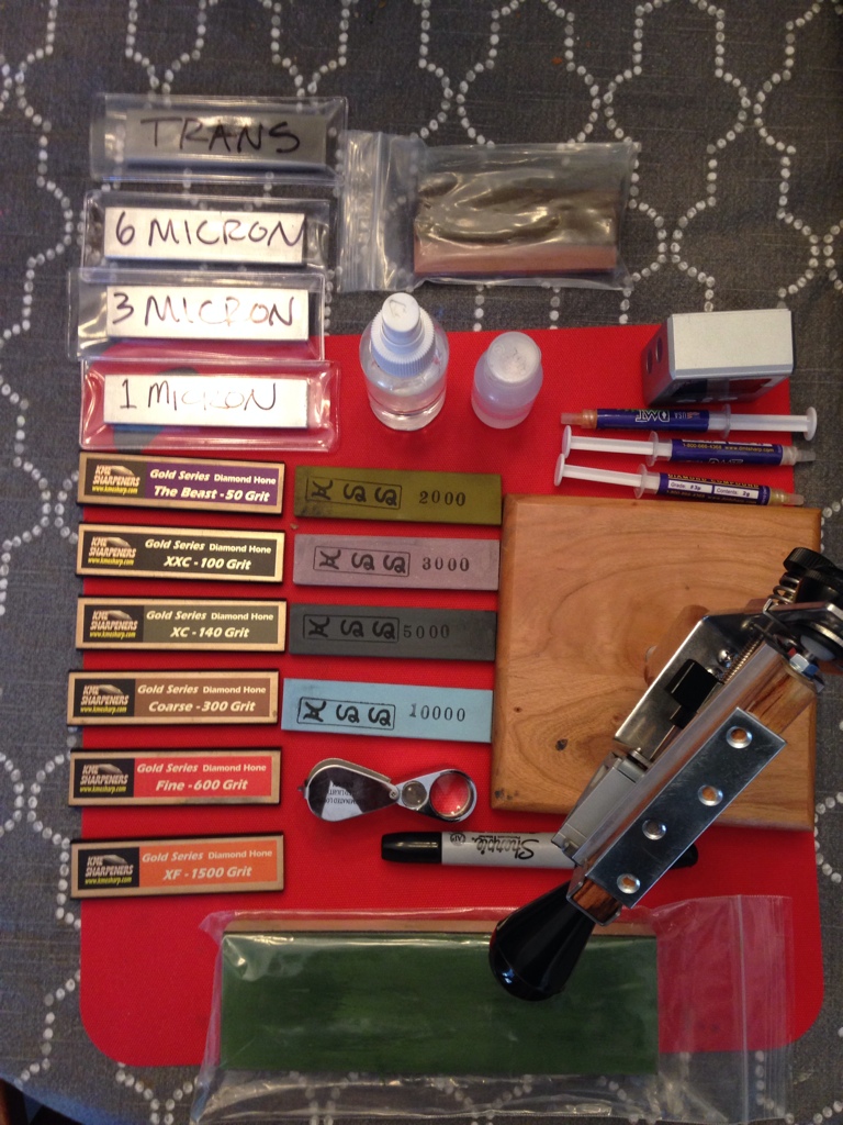

This is my current setup.

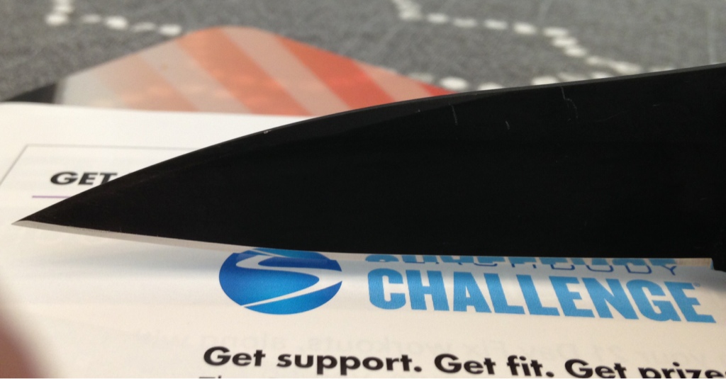

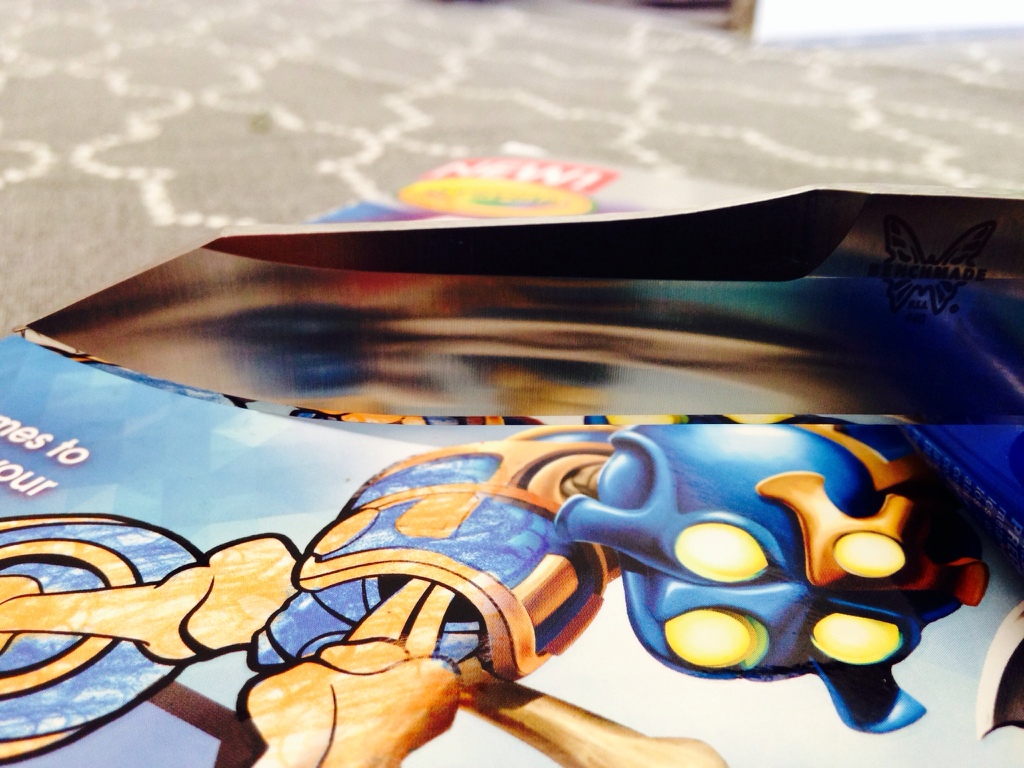

Edge without chosera finished with 1500 diamond, Arkansas translucent and dmt diamond.
Edge taken all the way to 10k chosera and 1 micron roo strop.
Those edges look great!
Thanks man! One trick to get a slightly better polish when using stock stones is when finishing up on the 1500 diamond is to use sideways strokes along the length of the blade <-----------> instead of up and down. It cleans up the scratches better.
