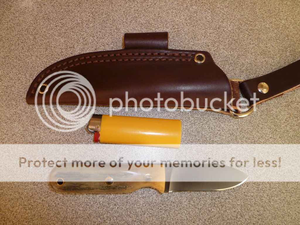

Hey...where are the pictures ;)
One picture along with a known traditional knife (slipjoint or SAK) would be much appreciated :p

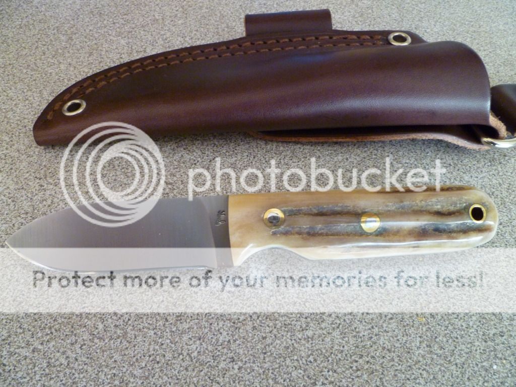

As you wished, friend. :)
NICE!!!! :thumbup:
Yea, I like those both. I think this combination could take care of most of my bushcraft needs. The Bushbaby for heavier cutting, batoning firewood and making woodchips to get a fire going. The Trapper for lighter cutting and everything food related. Also looking good while doing it. :cool:

I had looked at their bush knives earlier this year and was very impressed!!! I really like the Kephart style bushcraft blades. :thumbup: The trapper is the perfect complement to it!
Looks like it comes with a sturdy, functional sheath too.

Thank you :)
Is that a full size Case Trapper, or a mini?

Yes, it's a full size trapper. Yes, they did them with wooden handles. No doupt some shops still have them.
