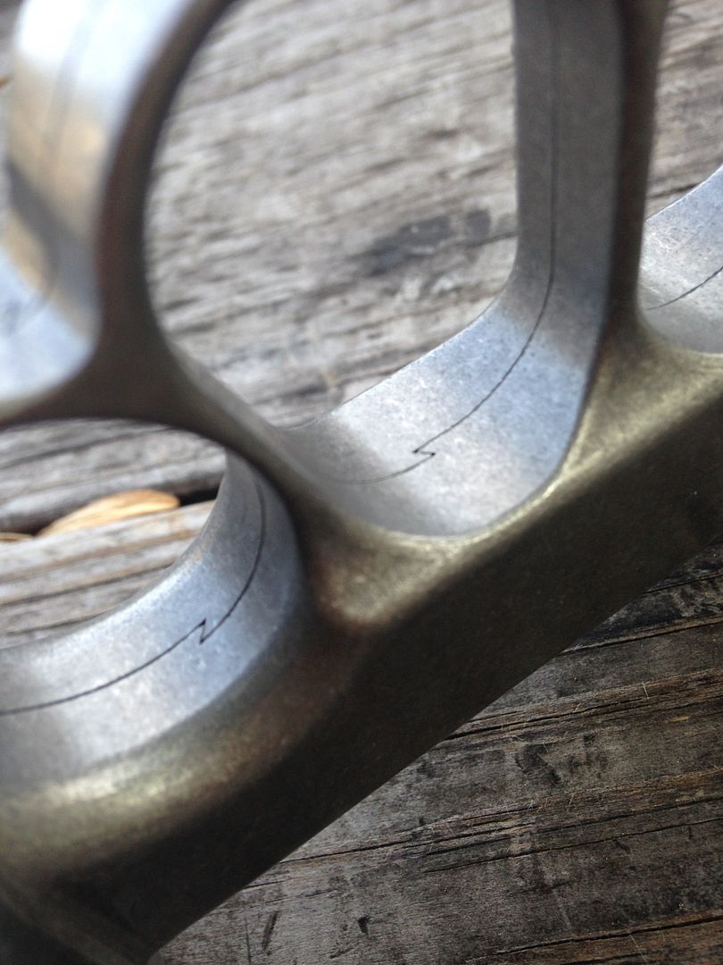

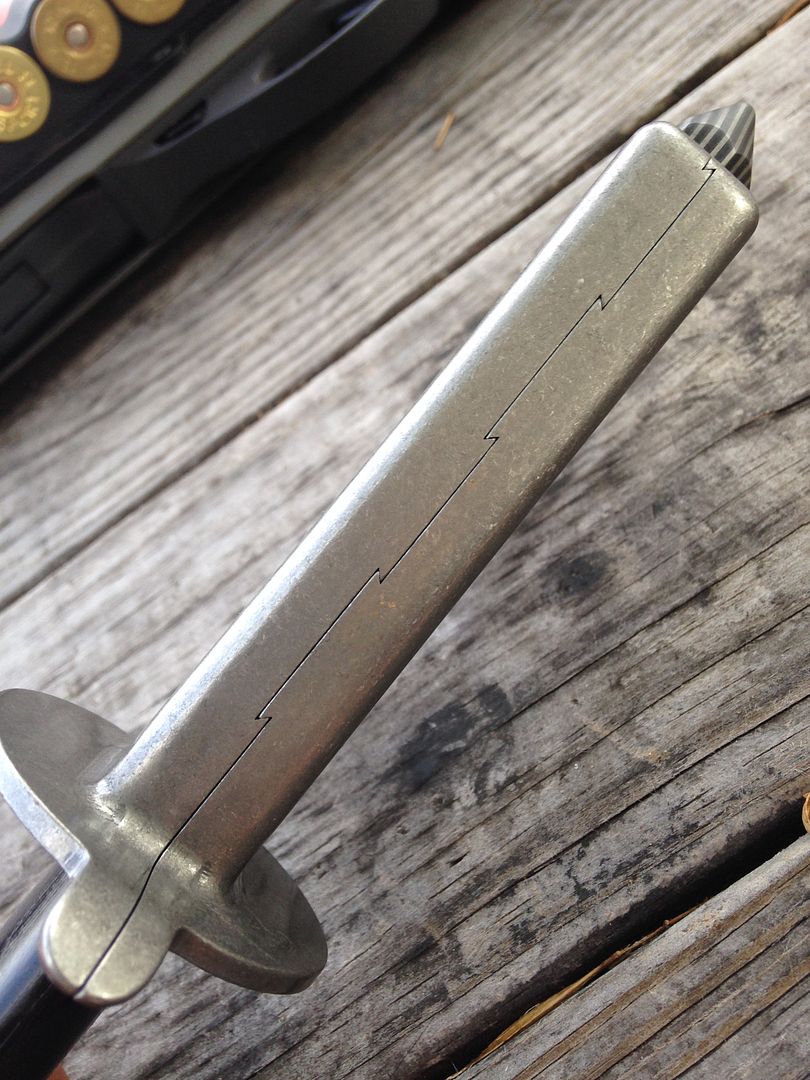

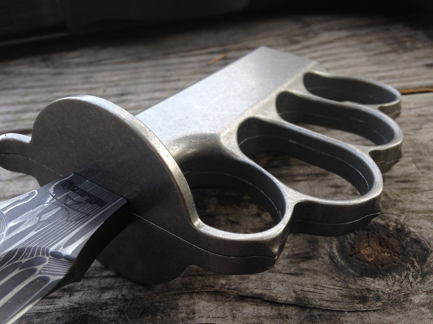

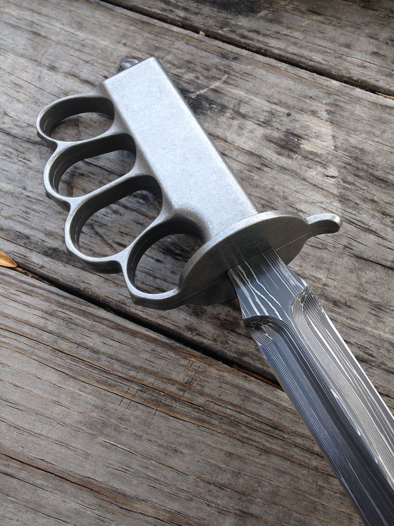

It only took 8 pounds of titanium to make this 9 oz handle. :)

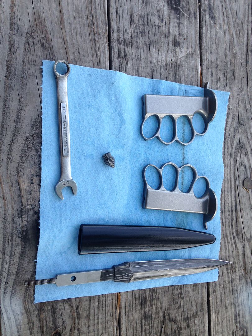

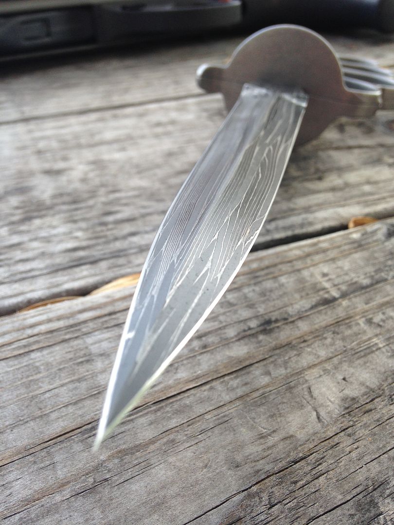

I didnt have any 2 inch wide titanium, so I have to make it out of 2 pieces of 1 inch Ti and dovetail the sides together. The tang wedges in and locks it all in place. Made the blade an inch longer than the originals because I wasnt gonna cut an inch off and toss it.

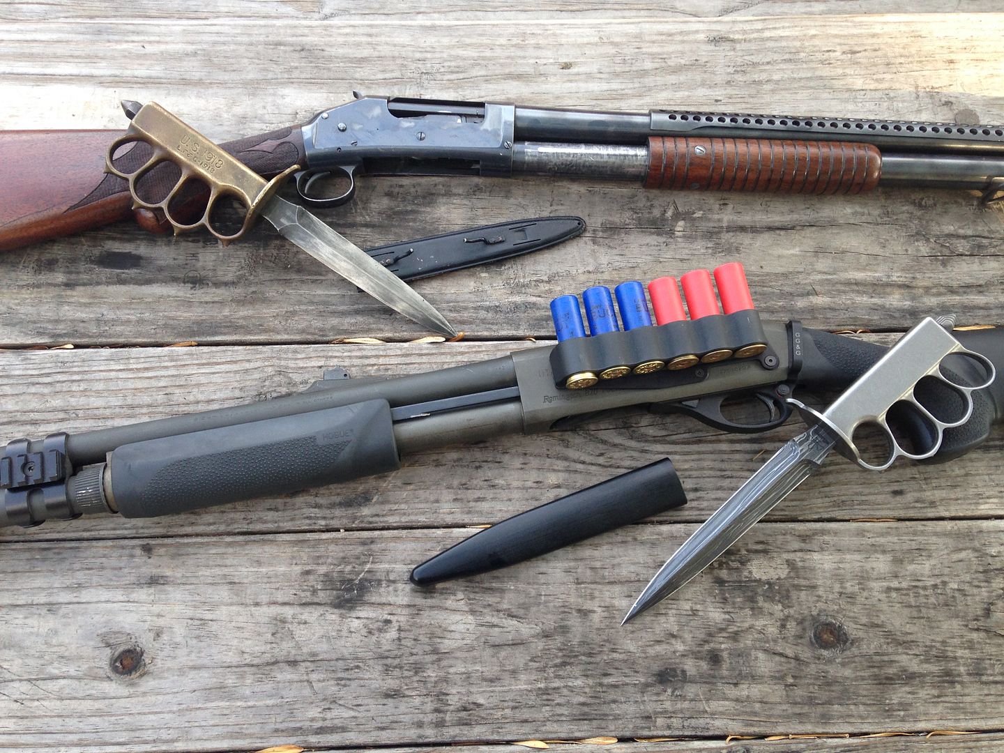

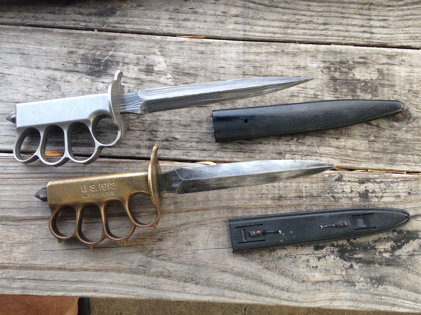

the sheath is made out of G10

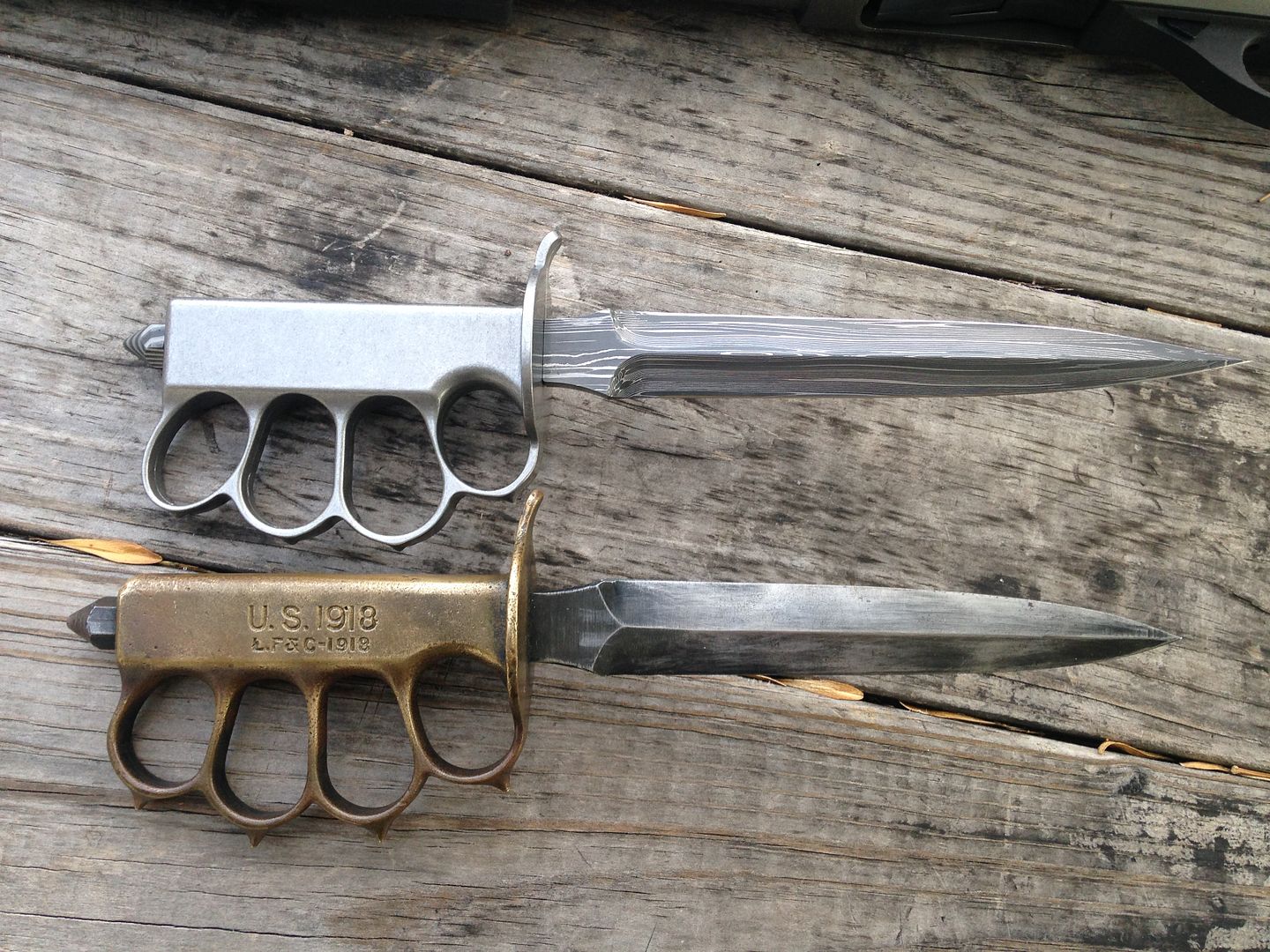

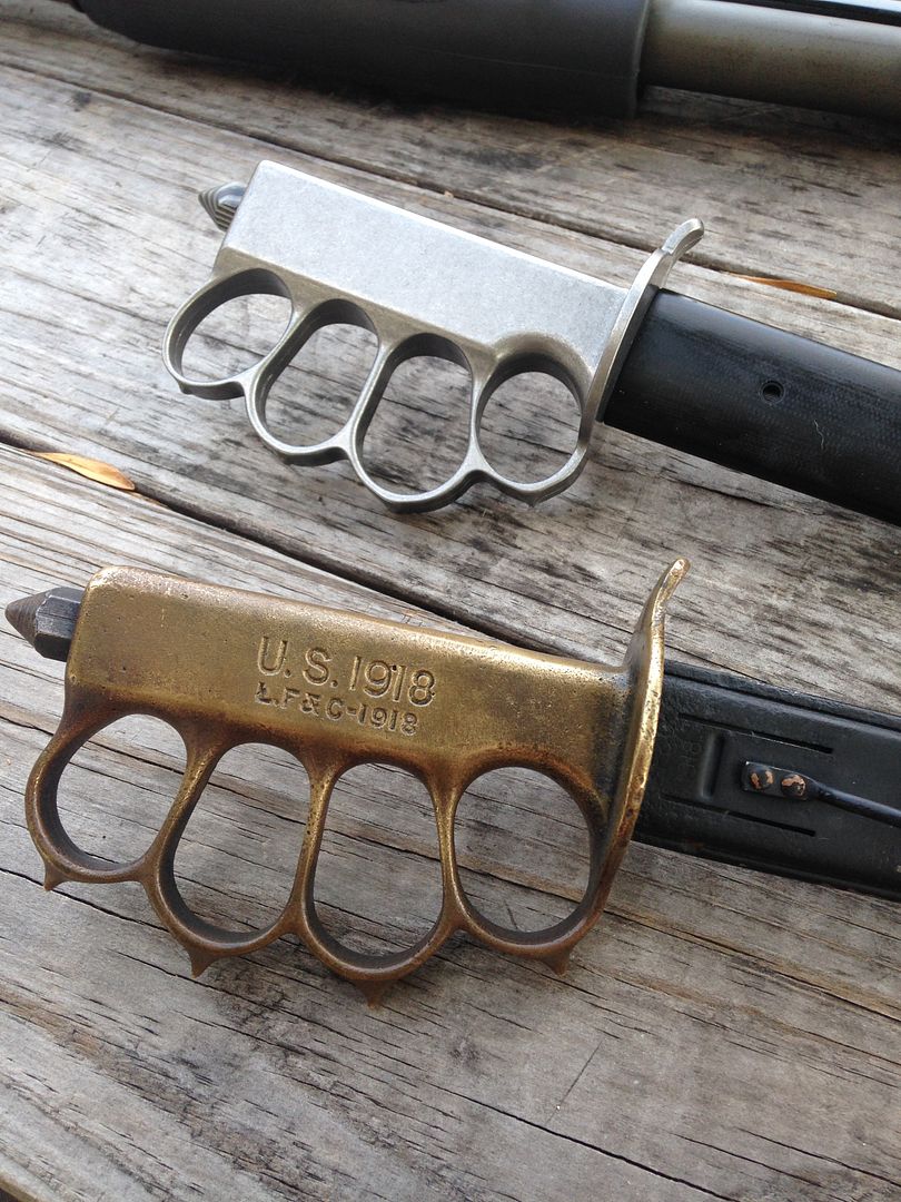

New and old, I couldnt resist

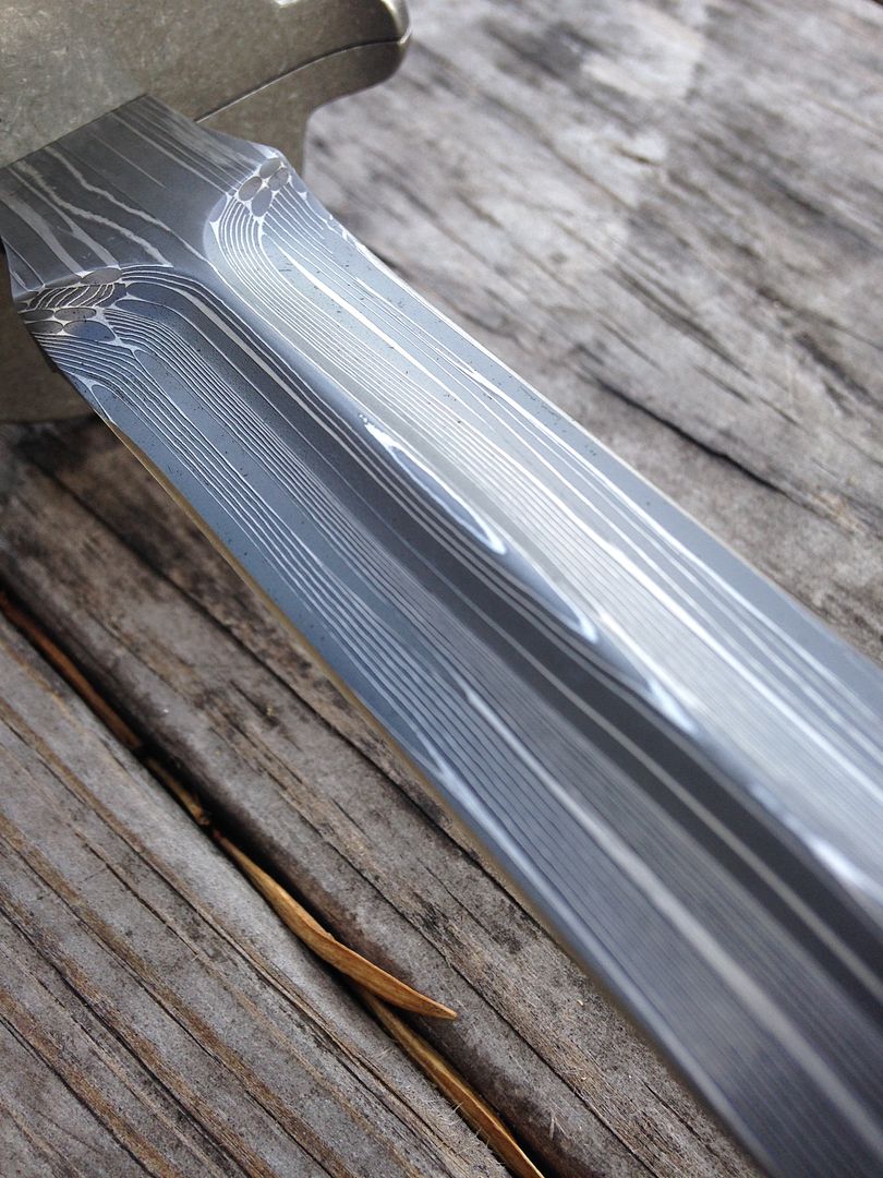

Extremely nice looking damascus on this piece and super nice guard:cool:.

That looks amazing! That is really cool how you dovetailed the handle. It struck me it would be kind of neat if the handle were engraved with U.S. 2015 and then your initials as the company name. Really stunning.
Great job my friend.....definitely a One-Of and as fine as any Knuckle Knife extant.
