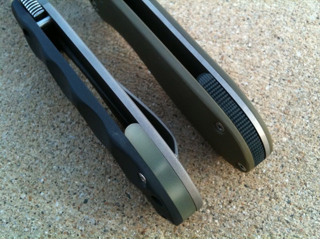

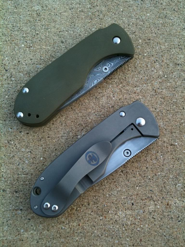

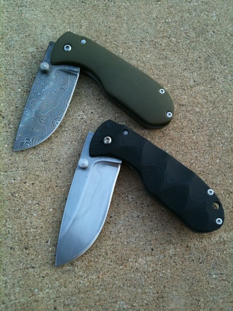

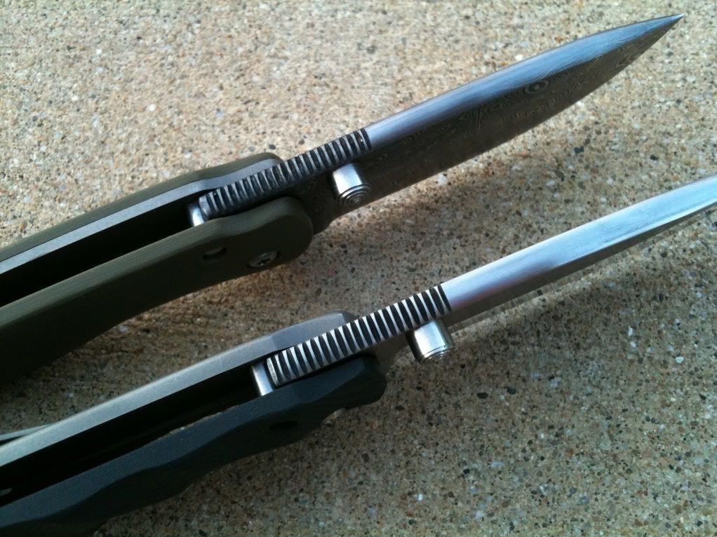

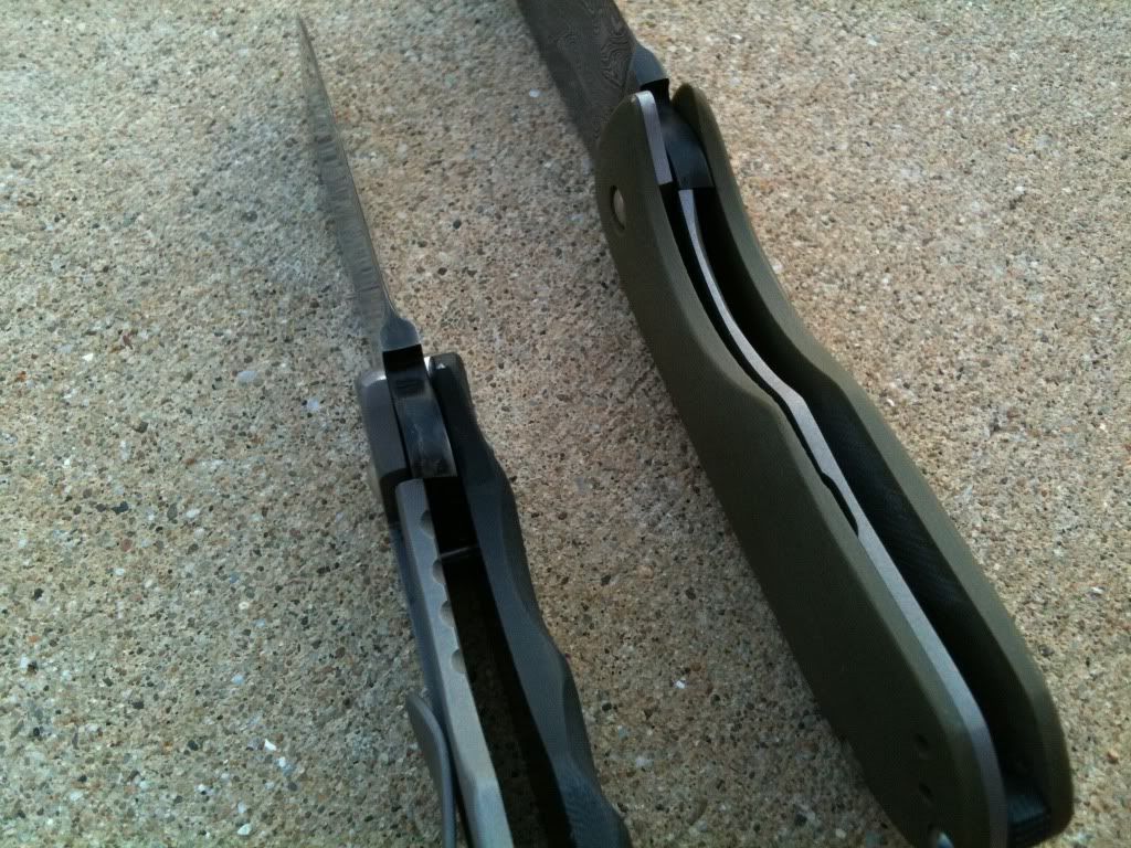

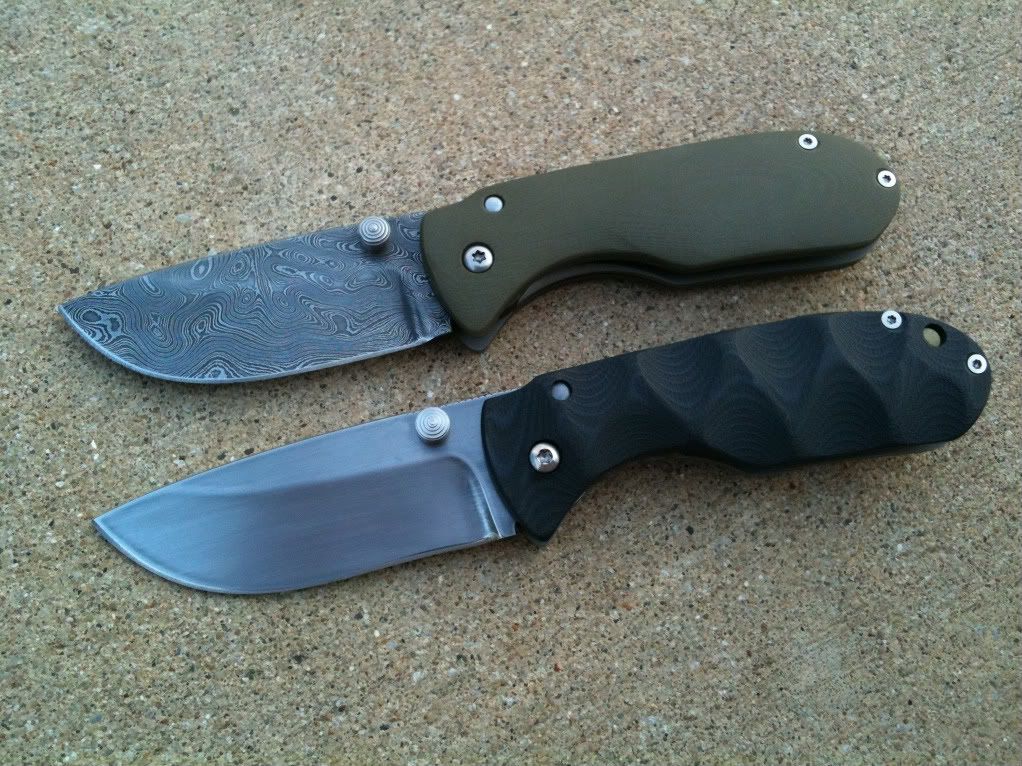

Wanted to share with you a couple of recently completed folders
Both have roughly a 3" blade or a little over.
The damascus piece is Al May Carbon steel Wormwood Damascus, I really love this stuff! .072" Ti Linerlock with OD Green G10 scales and a green/black G10 back spacer with checkering.
Next one is a Framelock with .125" Ti lock side and a Blue/black G10 non lock scale that has been scalloped and beadblasted. This one has a Jade Green G10 back spacer. The blade is 1095 with a hamon.
Both have nice early lockup.
Oh, both blades are 3/16" stock material. Sorry the pics are so huge, I couldnt seem to get them resized?
Thanks for looking, comments welcome and appreciated!
