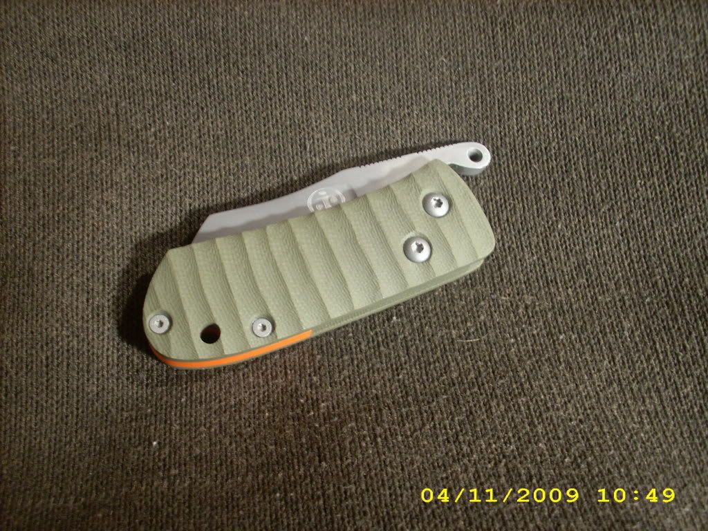

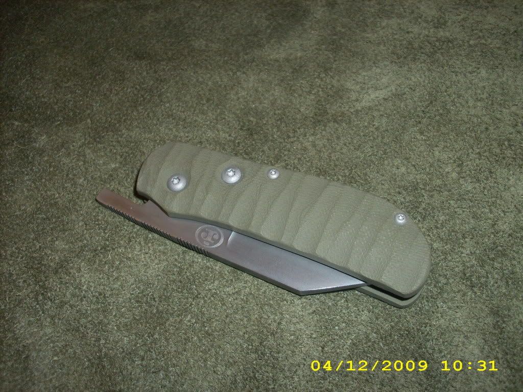

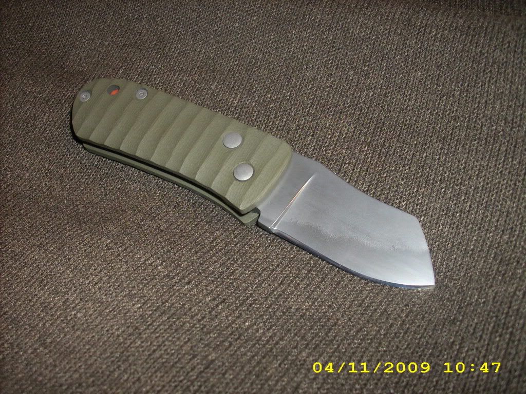

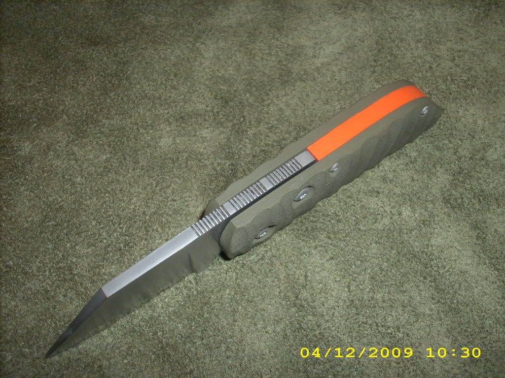

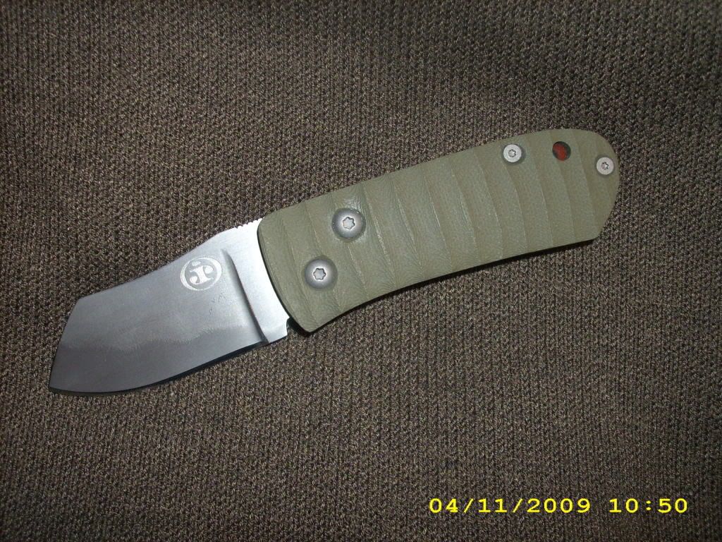

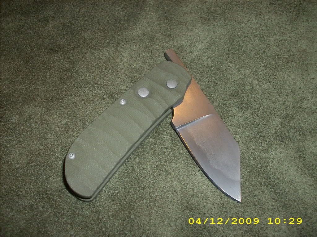

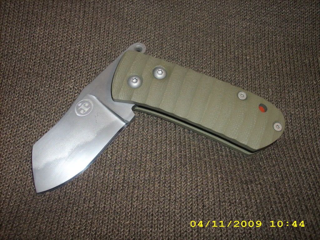

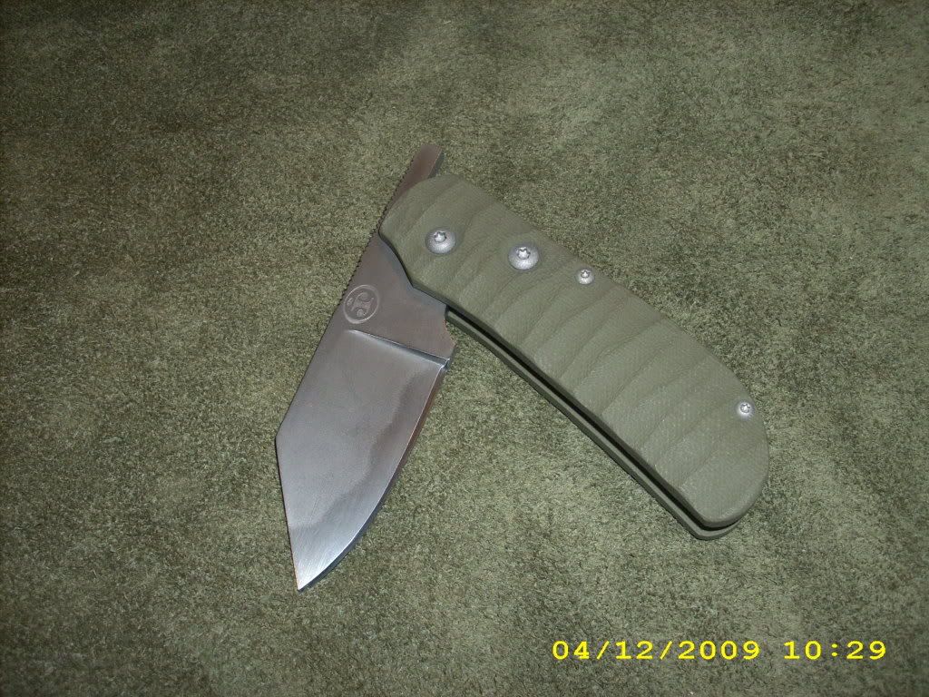

Heres a couple of recently completed friction folders I've made.
These represent my first try at creating a hamon line w/ Clay and 1095. Also the first opportunity to etch a makers mark on anything.
Feedback welcome and appreciated!
Thanks for looking
First one is my design for a good friend.
Second was a customers request to build a Friction Folder to his design.
Specs:
Blade: 3/16" 1095 w/ 2" cutting edge, Total length of about 2 1/4"
Handle: Olive drab G10 w/ Orange G10 backspacer. Grooved and blasted. Measures not quite 3.5" in length at longest point.
Blasted hardwear.
Specs:
Blade: 3/16" 1095, 2 1/4" cutting edge, 2.5" in OAL
Handle: Olive Drab G10 w/ Orange G10 backspacer. Grooved and blasted.
Blasted hardwear. The handle is 3 3/4" in OAL (I shortened it just a tad from the original design, it just fit better that way)
OAL: 6.5"

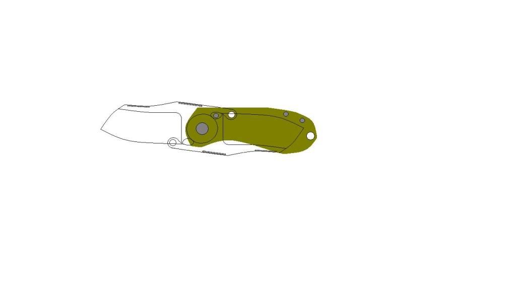

I'm thinking about making one myself; got the blade back from HT months ago, now trying to figure out the screws/pivot/washers/spacers/liners equation... Would you mind posting a shot of the pivot area, knife unscrewed?

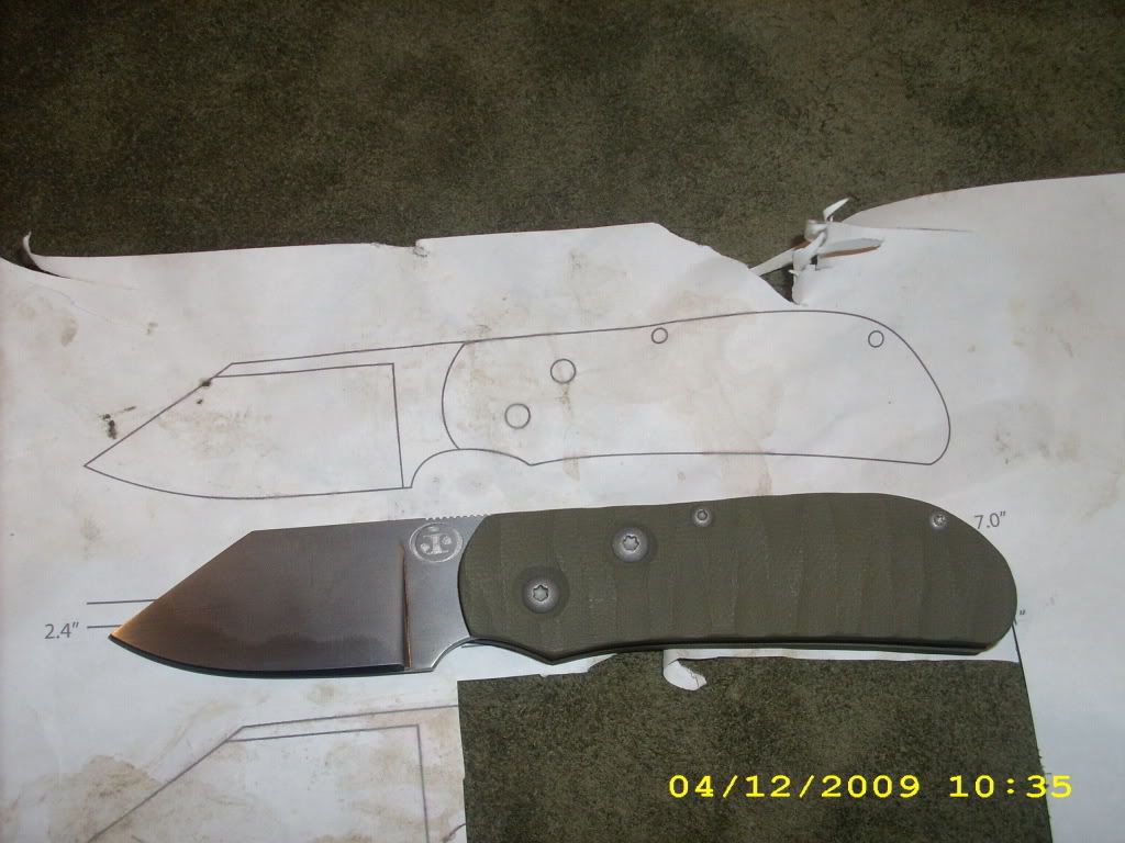

Sorry, I've already got these boxed up and ready to ship.
but, heres a layout of the design I based mine on. The customer asked for a finger coil on his, so the layout is a little different.
This is just what I use to give me an idea, I do a lot of subtle grinding after I get the basic shape ground for fit in the open and closed position.
But this should give you an idea of what the insides look like.

Liner-less...all of the above I guess. Plus, just an easier build. That, and there really isnt any need for a liner in a friction folder. The G10 is plenty tough, very rigid, but mainly, since there is no locking device, I dont really see the need for a liner.
However, if you wanted to add a pocketclip or something, then you would probably need a liner as I dont think the G10 will hold the threaded screws.

Well, then you will need a liner for a stop pin if you do it as you describe, forgot about that part. But, I just use a 3/16" step pivot and that works well.
Nope, the washers are fine, yes..the blade is the moving part.
