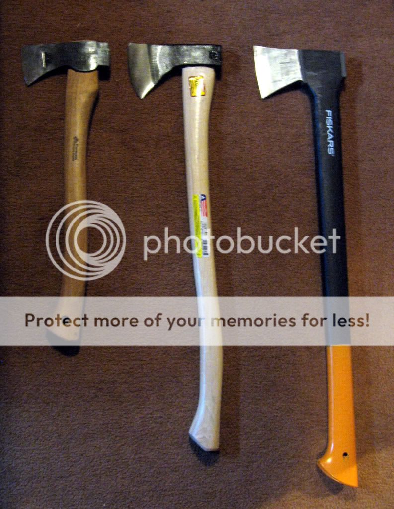

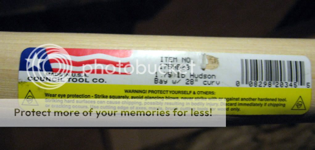

Got my Council Tool Hudson Bay Axe in today and my initial impression is good. The handle came with a nice straight grain with no heartwood, though there is a rough spot on the bottom of the handle (not a big deal). The biggest suprise is that the total length of the axe as measured from the top of the head is only 26" long. These are listed on Council's website as a 28" handled axe, but as Kim from Council points out, this is before the final production is finished and the axe handle is trimmed.
So, in actuality this axe is the same length as the Wetterlings Scandanavian Forest axe, with the exception that this one has a 1.75lb head and the Wetterlings has a 1.88lb head. I personally don't care for a 24" handled axe as on the Snow & Nealley Hudson Bay, as I would rather something a little longer for more swing and power, otherwise I'll just take my 19.5" Wetterlings Large Hunting axe.
So, back to the Council Hudson Bay axe! The finish is about what I'd expect for a mass production axe. There is an extra glob of varnish on the top edge and the previously mentioned rough spot on the bottom of the hickory handle. Otherwise no other things to report.
As for the edge, it's what I expected, a traditional "sharpen your own" deal and came fairly dull. However, the profile looks good just like the Council Boy's Axe I have from them (the Boy's axe was a freebie because the bit was bent and the bottom of the handle was a bit messed up, so Terra Tech sent me this one as a replacement which is a great credit to their customer service). It was easy to sharpen the Boy's axe and it was soon chopping as well as my Wetterlings Large Hunting axe and my Fiskars Large Chopping axe, so I would expect the same from this Hudson Bay as well.

Comparison between Wetterlings 19.5" Large Hunting Axe and Fiskars 28" Large Chopping Axe
