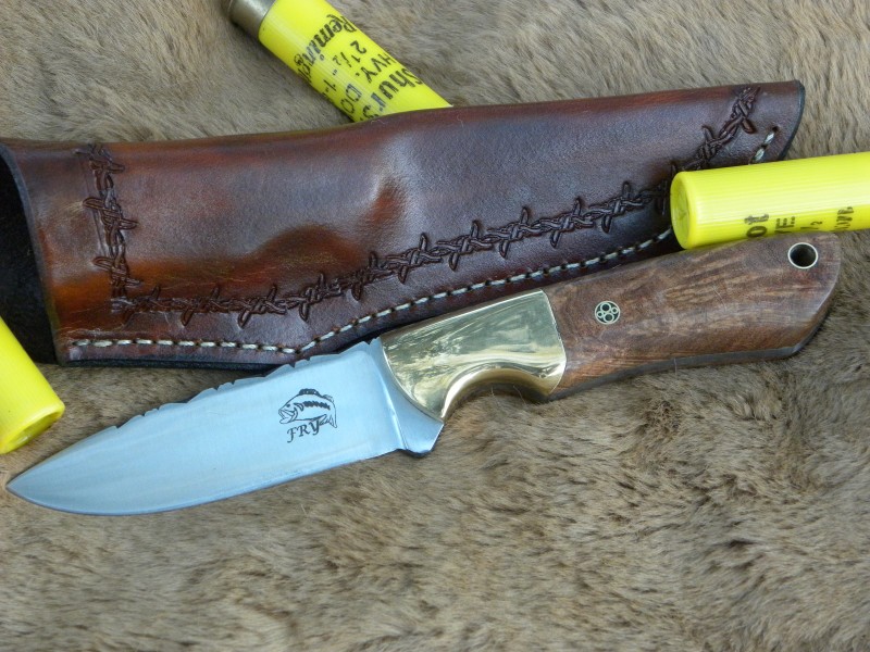

Wise guy, eh? These all came off my craftsman. In the first picture is a blade forged from a leaf spring, one from 440C bar stock, and one from D2 bar stock. Second picture is 1080. The machine has its limitations, and they're likely visible in the knives I've posted, but you're the one asking about a cheap grinder. I outlined its limitations, and it is what it is. No need to be snooty about it.
Wow, I think those are some great looking knives!!:thumbup: Nice work, especially considering the machine you ground them on. Your handles are beautiful.
