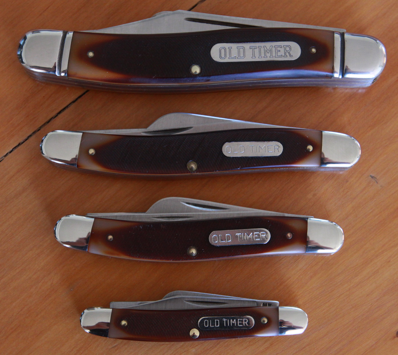

My (US) Schrade+ and 1095 equipped Old Timer 6/7OT's (20°inclusive edge) can process roughly 2.5 deer before stropping.
