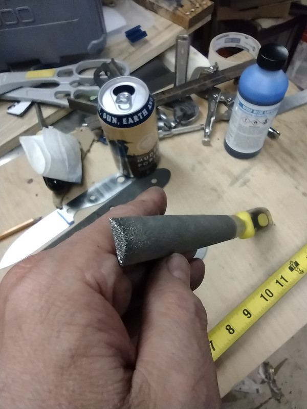

This is what you want ....
I bought this for wanting to put a finger choil in one of my Beckers, before I realized that I didn't like choils.... Turned out Great, btw
I've also used it to clean up the dogsh*t ugly tip of my 1311 after I removed all that paint they use to hide the crappy looking grinds. Also did pretty good.
I now use it to smooth out my profiles on My blades that I make. I work with Very Hard steels, and this breezes through them all
I bought it on the big river, cheaply.
I'm going to buy another to keep it cleaner.
And as a backup.
I found a 10" Temo brand file with 60 grit diamond coating that looks just like yours, Crag the Brewer Crag the Brewer , except the one I found is flat on both sides (as best I can tell from pics). I may also try to find a 200 grit one for less aggressive sharpening of larger blades.
I haven't had a chance to look mine up yet....
It is coarse. But honestly works fine.
Although I'm comfortable with coarse grind sharpeninr, too
