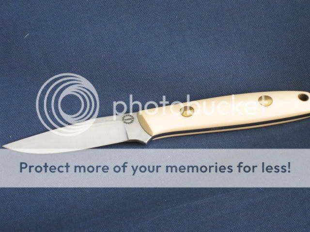

D-2 tool steel, and made by a man that learned the trade from Bob Loveless himself! :thumbup:
I prefer the "General Camp and Hunting" but Bob Dozier has a knife for just about everty need. :)
Dozier knives are very popular out here in the Rocky Mountains of Colorado. And for good reason!
