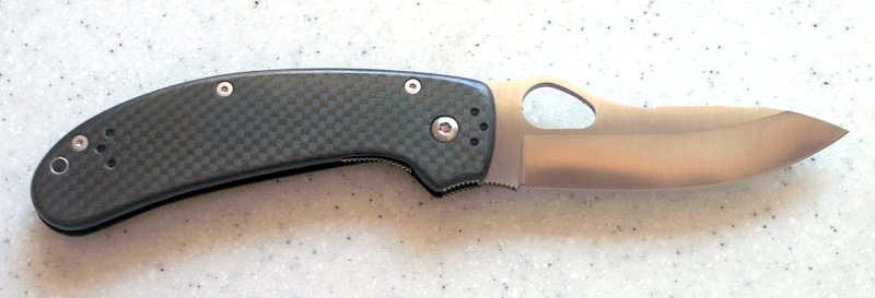

I bought one of these recently on the advice of 'shootist16' from a previous thread.
I like this knife a lot, but a couple of points not mentioned before:
1. There are 3 'thumb serration' areas on top of the blade- behind the hole, in front of the hole, and out towards the tip. Together with a serrated arc formed by the liner and choil (on the bottom) this is a great feature.
2. The carbon fiber scales (which are on mine) have a finish that looks like it's been varnished. I don't think it can get this way by polishing alone. Not only is this ugly (to my eye) but it is slippery. I lived with it for about two days, then sanded it off and worked it down until I finished wet-sanding it with 2000 grit paper. This is what carbon fiber is supposed to look like:
http://www.manicreader.com/gallery/latest/bladetech-wegner.jpg
3. Which brings me to the 'eccentric pivot pin'. When you re-assemble this thing, you have to iteratively push-out, rotate slightly, tighten and check blade lockup. It took me many tries to get this just right. It works, but none of my other folders have this 'feature'; I just throw the pin in and lockup is tight.
Overall, a great knife for the money.
