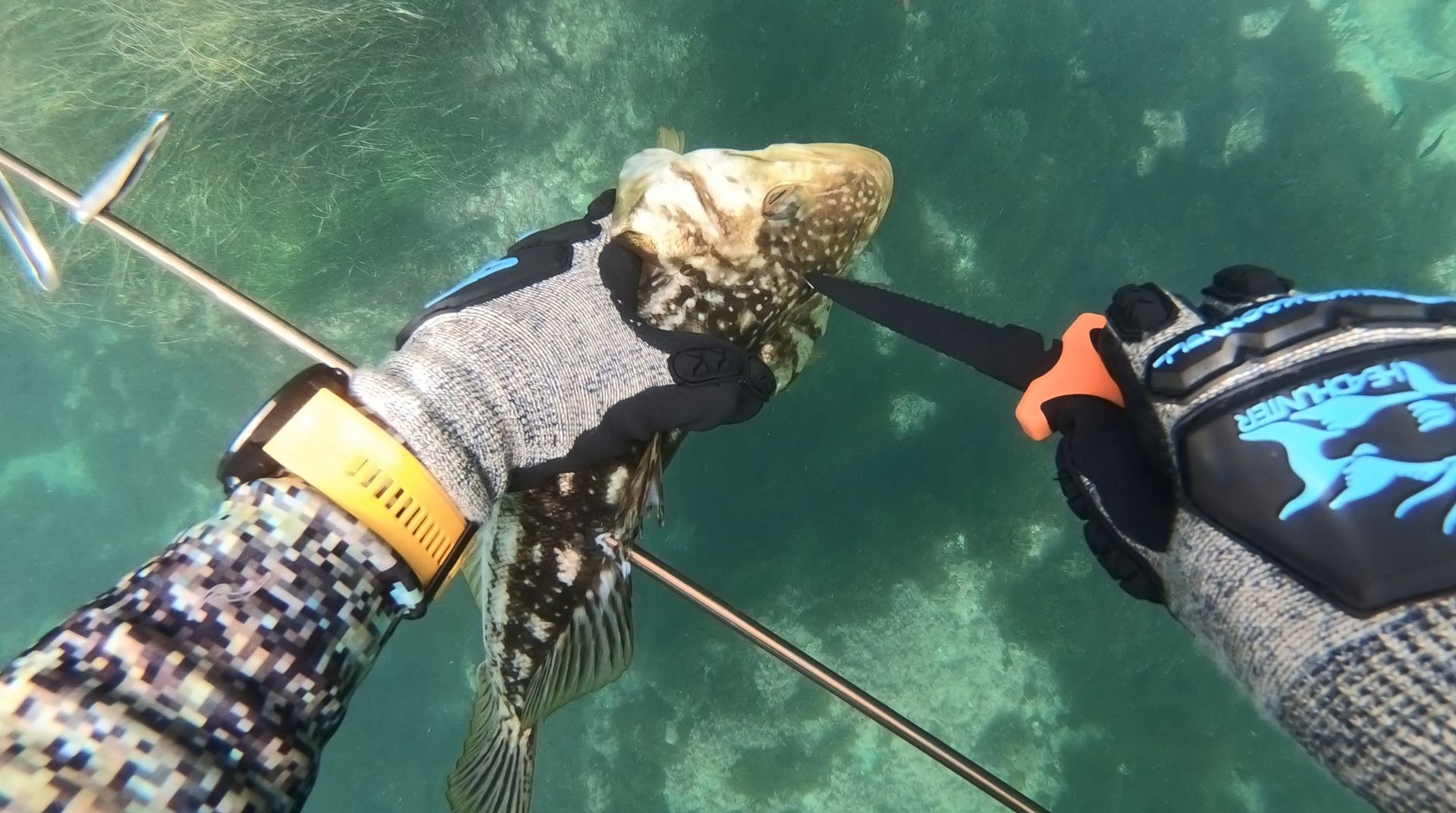

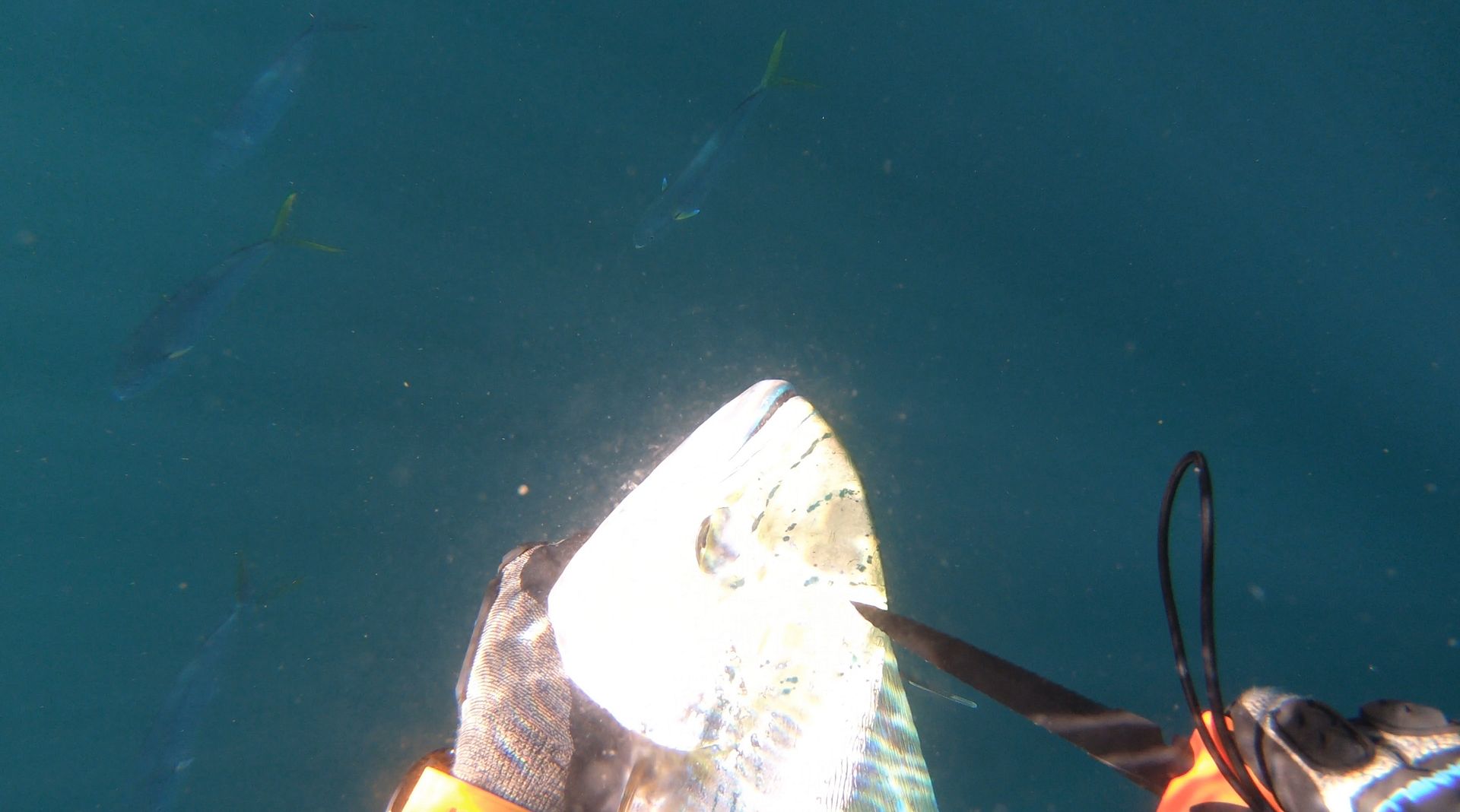

Knives for free diving and spearfishing are different from "dive knives" for scuba.
Spearfishing calls for quick dispatch of a fish so a dagger type design works best.
A general "dive knife" that can perform utility tasks should not be a dagger design.
