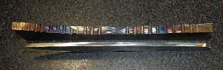

Thanks for all the suggestions and help. The first one is kind of well on its way. Really need to get some good belts though otherwise this is gonna take a while. I have some finishing on the overall shape but that will wait till I thin it out a bit and get closer to the thickness the final knife will be.
Be careful not to get TOO close to the final thickness of the knife before heat treatment. Remember, you're going to have to remove some decarb post-HT in order to get to the hardened metal underneath. The usual advice to beginners is not to make the edge any thinner than a dime... which, by the way, may be taken to mean a well worn dime.
