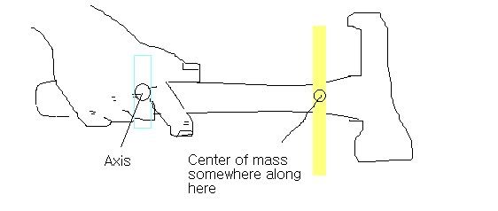

a knife is not a hammer, at least it shouldn't be. The balance is different. If you were to put a pommel on the lead hammer, you'd get a better swing at it and drive nails faster. To show you what I mean
this is the balance and will affect how much your wrists will work (I'm assuming that one uses his wrist to up that velocity). The weight is held by the arm, which have little to do with the impact. Speaking of impact(which is the same as momentum)
F (force) = m (mass) x v (velocity) ^2 (squared)
Force is not what drives the machete into the wood/bushes but impact
P=mv
which is the product of mass and velocity. In strict terms,
if we double the mass, we double the force. But if we double the speed, we quadruple the force.
if we double the mass, we double the impact, which is the cutting power and the same for velocity.
The impact allowed by the hammer:
As mentioned before, more weight of the hammer restricts its velocity. Why? torque. More torque is required if the center of mass is further away from the axis. Now we're getting somewhere.
What if the center of mass was somewhere along the middle? What if we take off the weight or add a counterweight? If we were to take off the weight, we would compromise impact for balance. If a counterweight is added, then neither mass nor velocity is compromised. This is possible due to the third class levers
ThirdClassLever.svg
The triangle represents the axis.
If the center of mass is closer to the axis AND a bulk of the weight is at the point of impact, then a great amount of impact(momentum) can be applied.
So, my suggestion to you is - if you want greater impact without sacrificing anything but a little arm strength, then add a pommel or some other form of counterweight to the handle end of the machete, as well as a bulk of weight at the other end.
