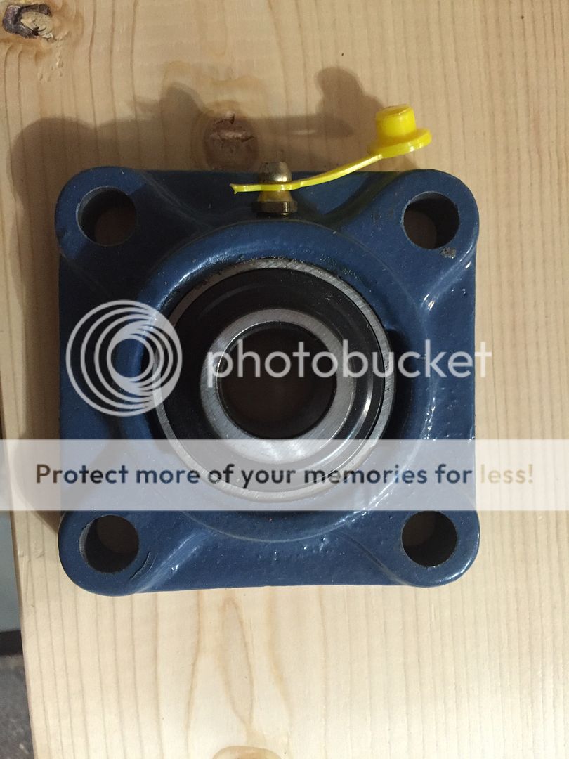

So, the "SKF" bearings I ordered off ebay arrived, and I think one or both is fake (i.e., not a real SKF). I knew the sub $40 price was too good to be true. I'll buy replacements from McMaster Carr or another reputable source from now on. I installed the one that looked more legit and tried to get everything trued up, but I think things are still a little wonky. Brian F's post was a big help and I have a better idea of what to do now. When I have a free weekend (and new, quality bearings) i'll try again. Until then I'll run the grinder on the lowest speed pulley.
Here's a pic of the "SKF" bearing that I didn't use; call me crazy but the hole in the inner race looks a little off center:

Read page four
http://www.irusa.com.br/catalogos/Timken/form638.pdf
I read through page 4 (and pages 3 and 5), but I can't seem to figure out what I should be looking for. Is there something that indicates that the off-center hole is supposed to be like that? If so, that would be awesome.
That is for the eccentric locking collar.
cam (self-locking) collar
Page three on the document, page four on the PDF reader
