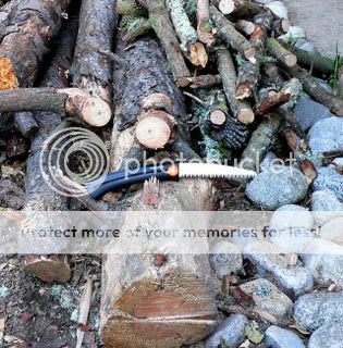

OK I just came in from the backyard. I found a 2 1/2 inch branch and sawed pieces off with three folding saws. This is how it came out. The Silky saw went through in 23 stokes using just light pressure, letting the blade do the work. The Laplander went through in 26 stokes using about the same pressure. The little Gerber saw took about sixty stokes to go through the same branch. In it's defense it has a two inch shorter blade and it's the lightest most compact of the three. The silky cut the fastest but pulls just a bit harder,(bites more) Than the Laplander although neither required much work. The Gerber and Silky come with sheaths and can be carried on your belt where you would have to make or buy a sheath for the Laplander or carry it in your pack. The Silky is the heavies of the three to carry. Sorry, I don't recall which model of Silky that I have but it has the same length blade as the Laplander.

The Bahco cuts on the push & pull cuts right? I just got a new 17cm silky saw pocket boy, havent had a chance to truly use it yet, but I like the design how the blade locks either straight, or angled back.
The silky has a pretty thin blade and only cuts on the pull. Does the Bahco have a thicker/more rigid blade?

If you're thinking about a Silky and can tolerate a little extra weight, consider the Super Accel 210 over the PocketBoy 170. The SA210 gives you about 1.6" more blade with a weight penalty of only around an ounce and a half. Silky achieves this partly by using an aluminum frame on the SA210 rather than the steel frame on the PB170. To me, the aluminum frame feels at least as strong as the steel (and I like the appearance better---not that it matters).
Another benefit of the SA210 is a blade that feels appreciably stronger. Mat at Silky told me that the SA210's blade is over 18% thicker than the PB170's. 1.3mm instead of 1.1mm. I noticed the difference immediately (which is one reason I called and asked about exact thickness). If I were carrying a PB170 on an extended wilderness trip, I might well carry a spare blade.
The PB170 is a great saw but when you want to cut something around 6" in diameter, the SA210 lets you do so more efficiently and without rotating the log as much. It also feels faster on smaller stuff. Mat told me the SA210 is Silky's most popular folder.
On woods I encounter in CA and AK, I like the large teeth on the SA210 (which are the same size as the XL teeth on the PB170).
