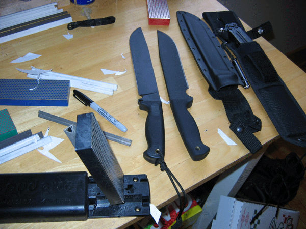

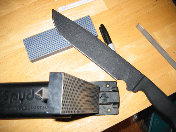

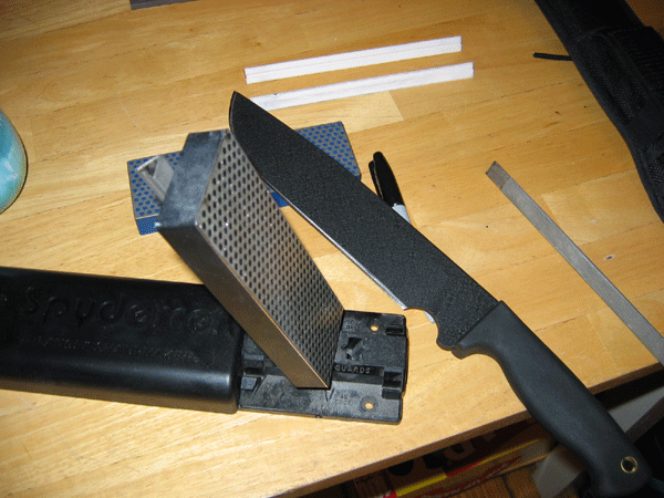

Just for fun, here's how I did them back in the day.. :-) I forget how many hours I spent per knife but it was not easy..
