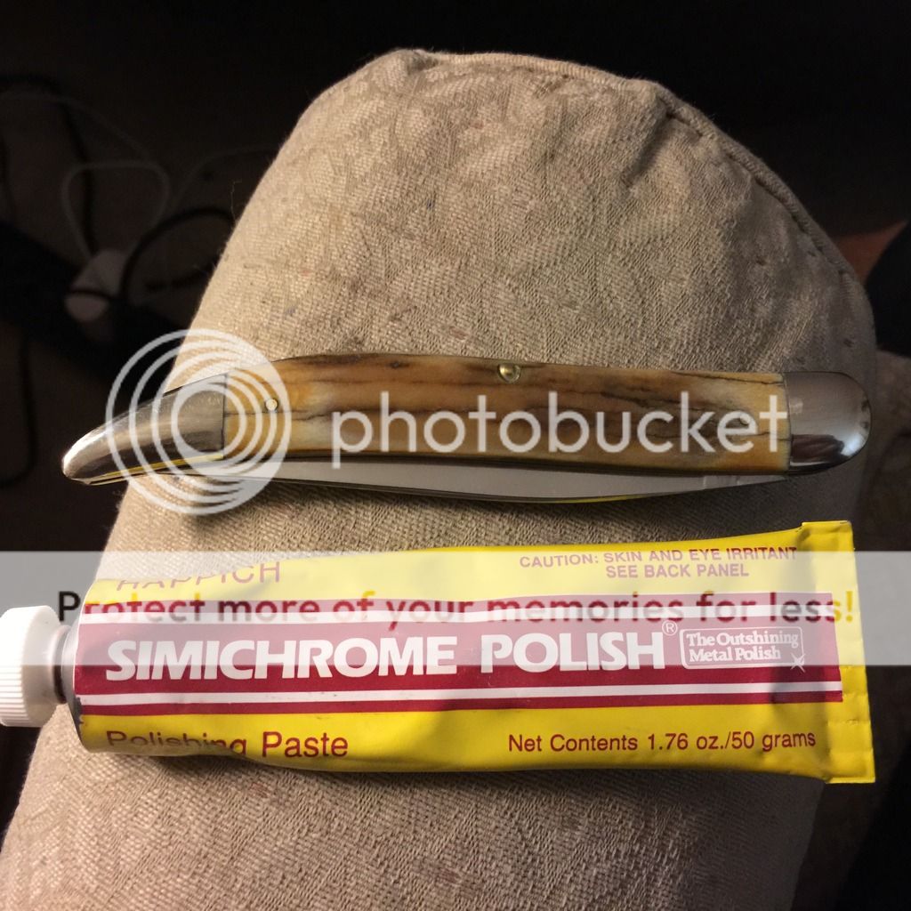

For polishing on my stag and smooth bone I use Simichrome Polish. It's a polishing paste made more for your blade but works great on a number of other items.

I've also used Simichrome to clean up some green staining (verdigris) around the brass pins on one of my stag-handled knives; it worked well for that, and will also polish the stag a little bit. If polishing bolsters with it (esp. nickel & brass), avoid getting the dirty polishing paste on the stag, as that can sometimes be tedious to clean up (but still possible with clean paste), as the darkened, dirty stuff will get into the grain. Covering the stag adjacent to the bolsters with some masking / painter's tape can help prevent that.
