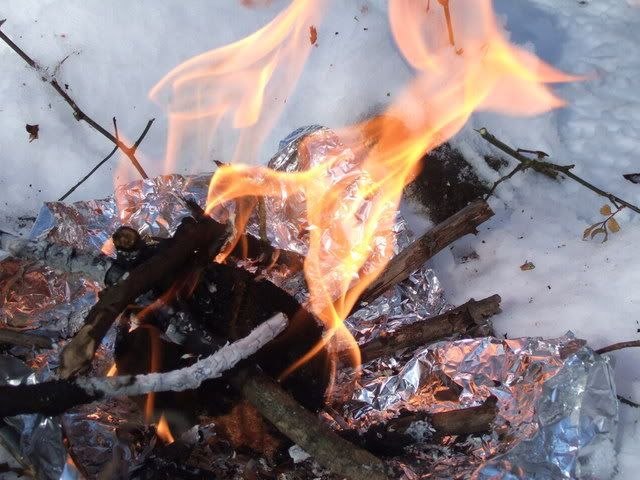

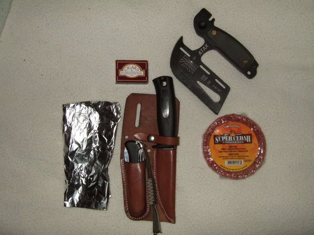

I use the vaseline-soaked cotton balls (make sure they are cotton). I put them in a film cannister or match safe, they last a long time. The other product that I carry with me is the BSA Super Cedar block. It is the shape and size of a hockey puck, easy to light and will burn for a 40 minutes on its own. You can also scrape off particulate from the block and use it for fine tinder.
Lower right:
Super Cedar producing high energy, self-sustaining oxidation in the visible range (Fire!):
