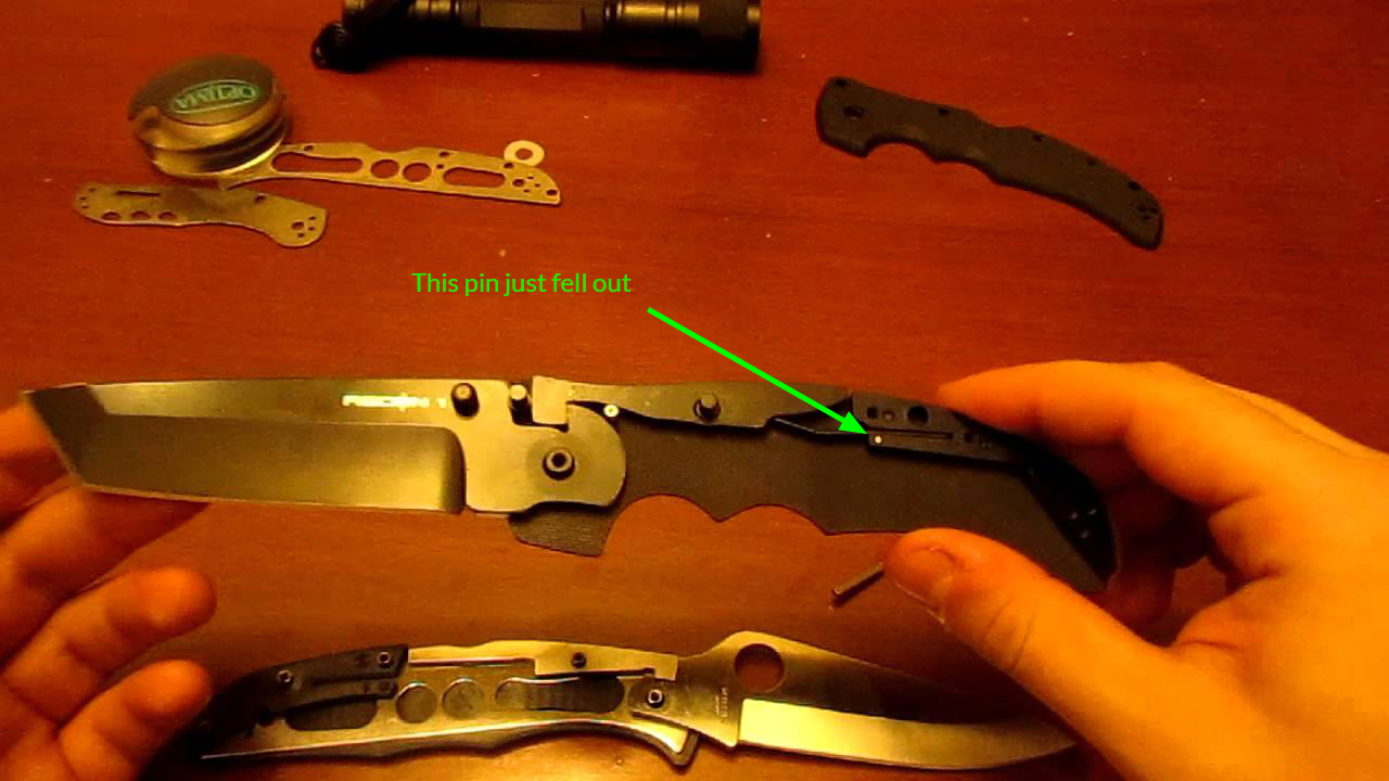

Hi everyone,
All of a sudden, my gen 2 Recon 1 (AUS 8 and triad lock) started rattling.
This happens in any position - when the knife is closed, opened and half-opened.
The knife is completely new, and so far I've just been breaking it in. No use whatsoever.
Lockup is 100% solid in every direction and everything works properly.
I found a similar thread which suggested that internal stop pin (that keeps the blade from hitting the lock / backspacer when closed) can be loose and rattle.
When I removed the scale, another pin just popped out. I pointed it out here:
(photo is from here)
That pin is simply shorter and I don't really understand the purpose.
Questions:
1. Should I just send this knife back to the store where I got it from?
2. Is there any quick-fix I can do on my own?
3. Can this affect performance, specifically safety of the lock?
Thanks!
Hi Ivanhoe,
I had the same problem. The little pin that fell out did the same thing when I opened up mine, but I believe that the pin is supposed to be loose. My XL Tanto Rec 1 was rattling when it was closed. I sent it back to CS and they graciously replaced it. Although the replacement knife did not rattle when I first got it, after several one hand openings during the weekend the rattle started up again. I fixed mine by putting a little locktite on both ends of the Triad lock pin where it inserts into the scales and the rattle went away. I also put LT on the main pivot screw in order to stop it from coming loose with use. She is very tight now, no issues.
Hope this solves your problem,
Alan

That pin is just one more thing to lock in the back spacer I believe. Anyway, if it rattles when open, or even halfway open, it is the internal stop pin. If it rattles when closed, it is the Triad pin.
Yes, the pin is there to offer support for the backspacer. See the long, relatively thin 'tongue' under the slot for the spring in the backspacer? The spring exerts pressure downward on this piece. And even though the backspacer is made from aluminum, it doesn't hurt to have the pin there, because the pin supports and transfers the forces into the G10 handle slabs. :thumbup:

All my Recons do this, i have a couple. Here's how i solve it:
I cut i minuscule piece of a plastic bag (the one the knife comes packed in), just a tiny tiny sliver.
Then i press that tiny sliver into the holes on both sides of the scales (so that's one sliver each).
I then compress it with a wooden toothpick, firmly into the hole.
This creates a soft padding on both sides and stops the pins from ratteling.
You have to make sure to use just enough plastic, to keep both sides even.
Works great for me.

The pin is there as a failsafe. The aluminum backspacer that holds the spring may not have deformed enough to press on the pin yet, but with use it will creep and the pin is there to make sure that it wont deform too much and cause the spring to lose pressure.

The thing is, if u know backlock mechanism, you will understand that that part of the backspacer only takes more load when the spring is flexed, i.e. when opening/closing the knife. So no, it would more likely fail from repeated opening and closing, doesn't matter if you hard use it or not.
So the pin is essential. That part of the backspacer for lockback knife are often supported, look at Spyderco Endura in the picture as an example, the "pin" was molded on the FRN backspacer.

You can also simply coat the pins with grease prior to reinserting them.
Totally eliminates rattle, yet isn't permanent.
