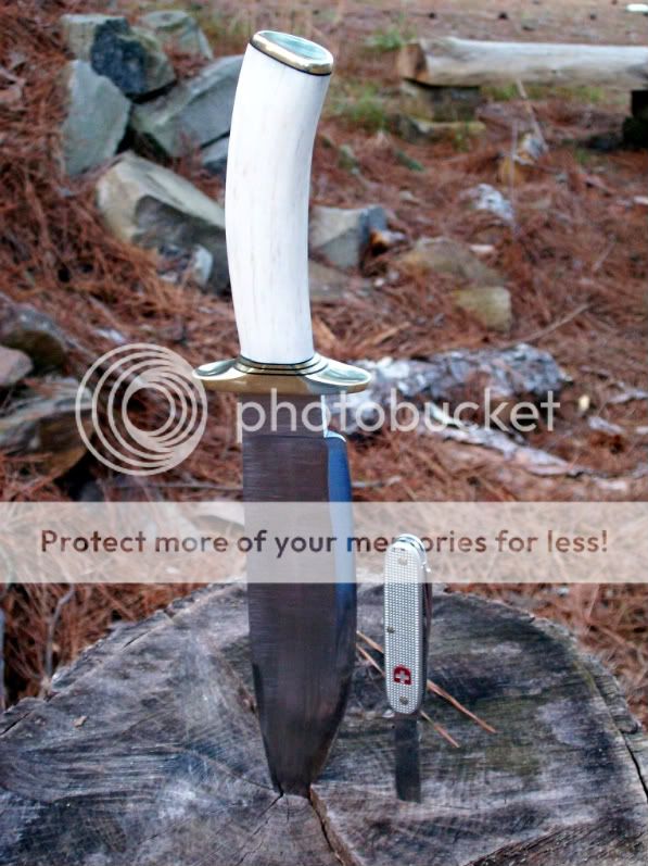

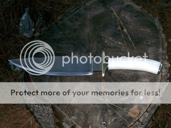

This is a picture of the first blade I ever forged.I forged it from an old truck spring.It's 16" OA with a 10" blade that is 2" wide at it's widest point and 1/4" thick. It has a convexed edge and is shaving sharp.
The handle is polished elk.I removed all the pith and filled it entirely with Accuraglass.
Sorry for the bad pictures.White seems to be hard to capture.
