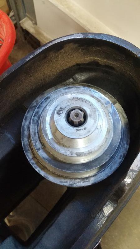

I am considering taking home a benchtop drill press from work. They are tossing it b/c the spline pulley is stripped. Looks like the spline was replaced about 19 years ago but the service is not offered anymore so ...I can take it home:) But can I fix it? I am not coming up with much on google for spline pulleys.
It is a craftsman 100 I think. Very nice machine except for the pulley problem. Anyone here with experience with these?

It is a 150 model actually. It looks like who ever fixed it did not actually use a spline pulley, it looks like a straight bore.. . I can wiggle the pulley, there is a TON of play. No visible set screws either. Im not sure how it is being held on...maybe a retention ring at the bottom.

It appears there is a snap ring in the bottom. Is it the pulley bore/shaft that has slop, or the bearing? Either way, it can likely be fixed, I'd snag it.

I have used a standard single groove cast iron pulley and bored it out a bit until it was a tight fit on the splined shaft. They have a set screw, and you can drill and tap it for a second one. Switch the motor to 3Phase and a VFD.
Check the quill for slop and runout. Replace the bearings if needed.

This pully still attached by a snap ring but otherwise just wiggles all around that spline
