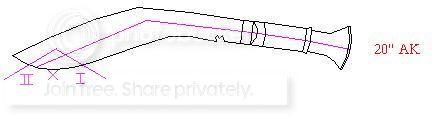

The sweet spot on a kukri is between I and II. The width of the angle between them increases as the medium that you are cutting gets softer, and the angle decreases as the medium being cut gets harder.
For soft vegetation, it's easiest to cut by having I be your striking point, and "running" the blade through to II. Same thing with harder vegetation like woods, but the angle is less, but the key is, even there, there should be some "run" to the stroke, they aren't that efficient in a straight-on chop.
As for a recurve in a smaller blade, I don't see it as being real useful, but there are guys that like the tiny 10 and 12 inch kukris (which only give 6-8" of actual blade).
I'd thought of the "sweet spot" in a khukuri being a little further back--actually, starting about at the place you call "I", and continuing back toward the handle from there, about the same length as the part you describe as the "sweet spot". If I remember correctly from some photos posted in the Himalayan Imports forum, their blades have their greatest hardness right between the curve and the point you designate as "I".
