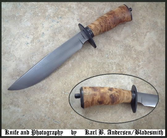

Here's a selectively hardened and etched 5160 recurved blade mated up with a piece of Cotton Wood Burl I got from Alpha Knife Supply at The Blade Show this year.
I had no idea what that Cotton Wood was going to look like, but I'm ordering MORE!
It is in my normal Take-down configuration and the faceted and fluted mild-steel fittings are polished, satin finished and hot-blued!
8 inch blade and 13 inches over all.
