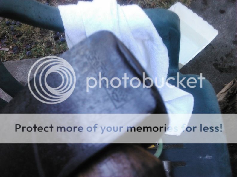

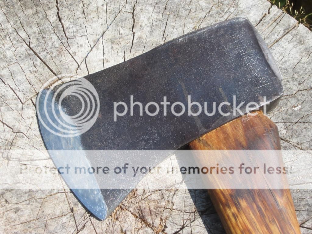

I saved this Collins Legitimus from the metal recycler for a whole $3.00 and this is what it looked like.
It had some mild mushrooming.

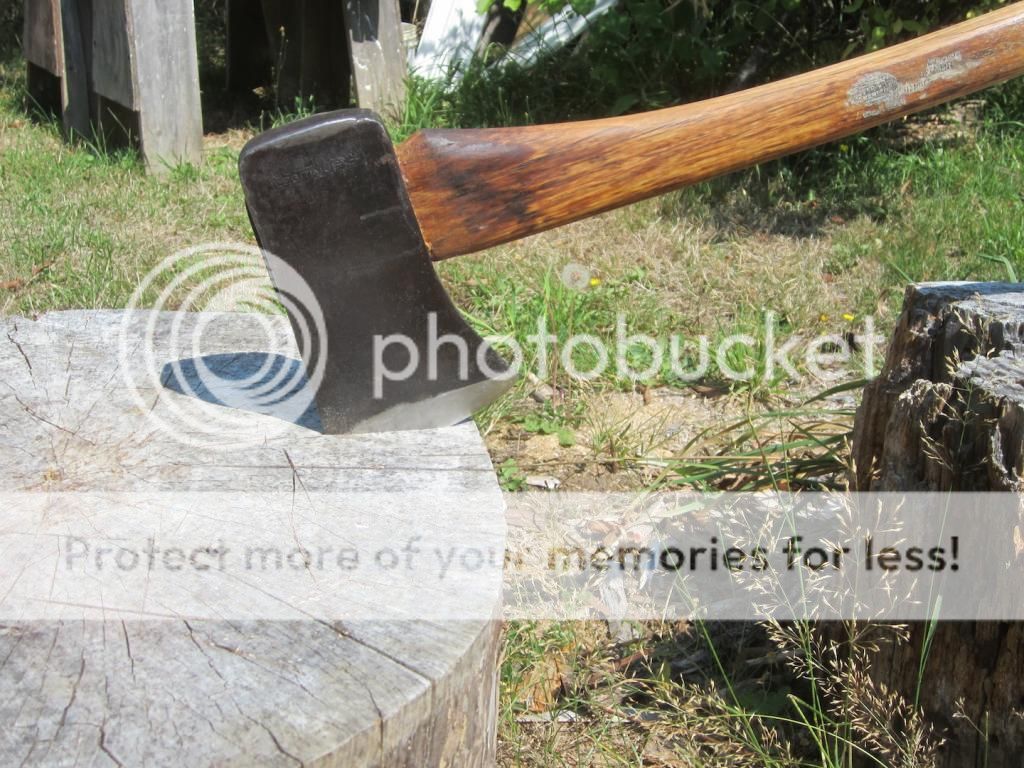

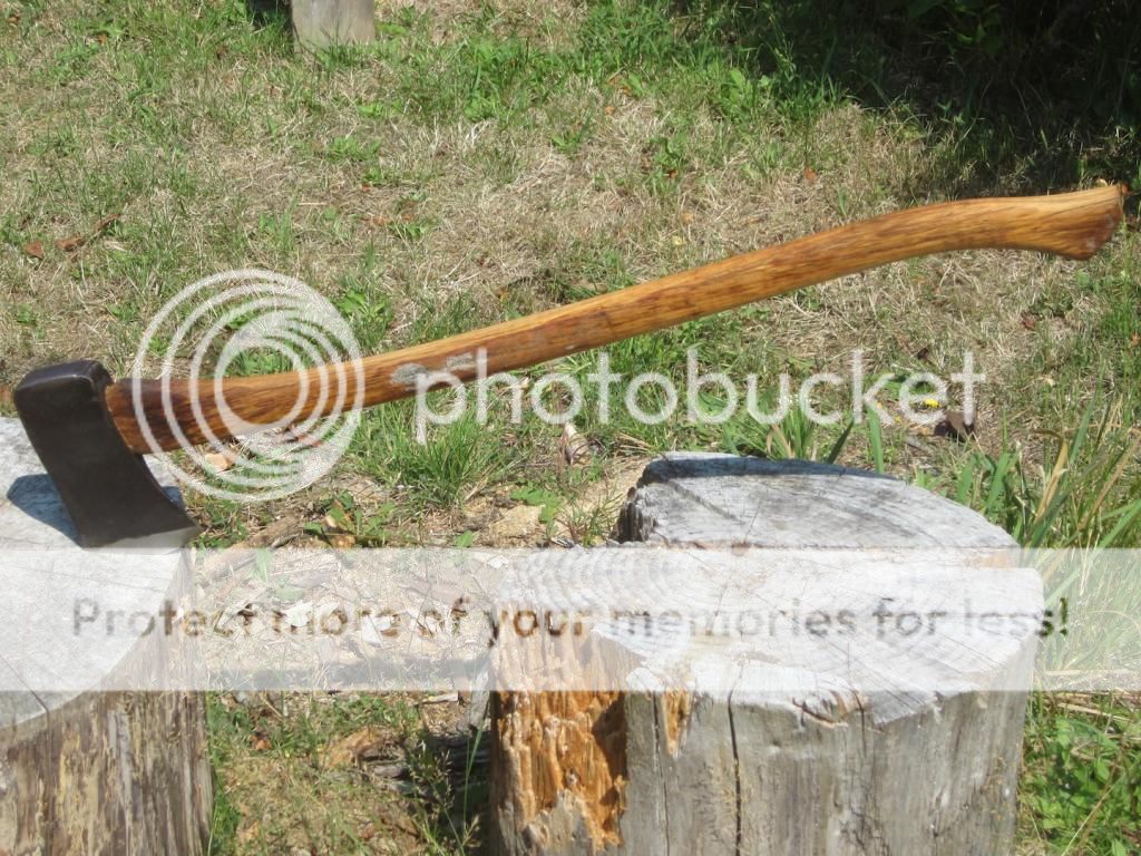

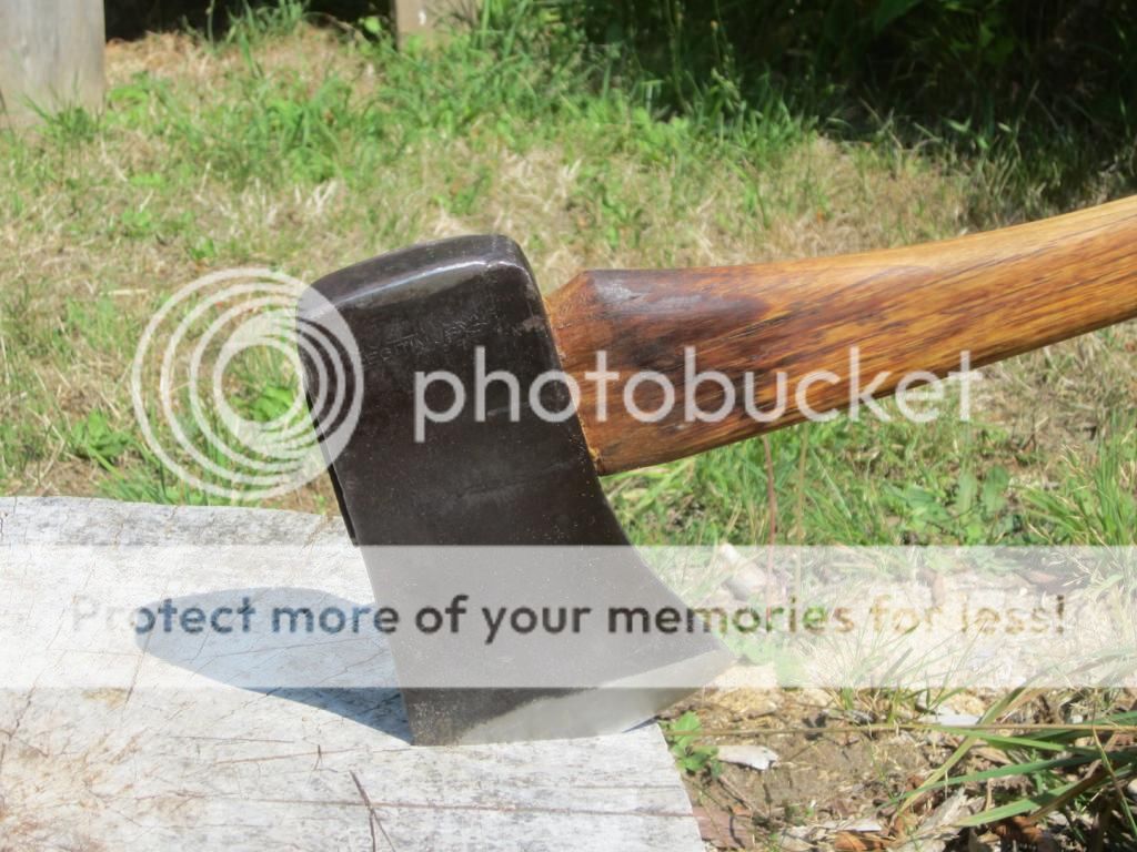

The haft is not original nor do I like the swell but it is a good length for this head and was serviceable so I decided to keep it. The haft was reshaped a little and thinned, then it soaked up multiple coats of BLO. I made an attempt to keep the Master Mechanics sticker on the haft.

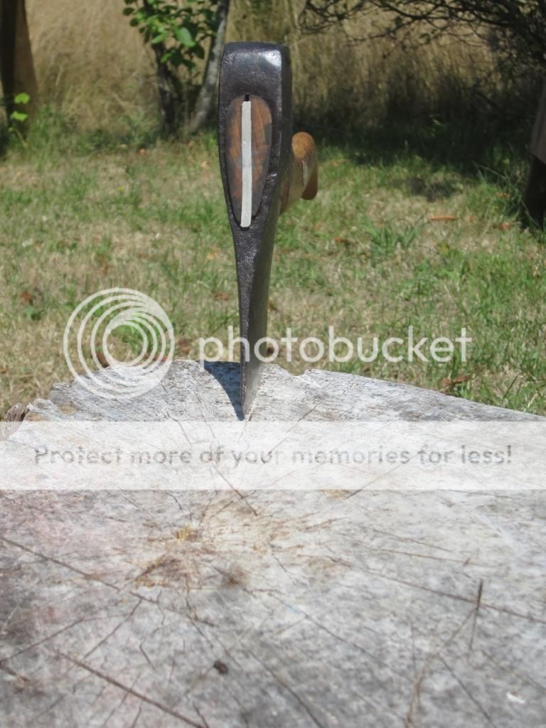

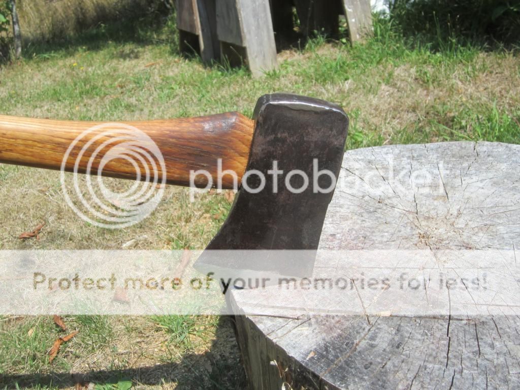

I reseated the head closer to the shoulder of the haft. Reused the aluminum wedge for fun and something different.

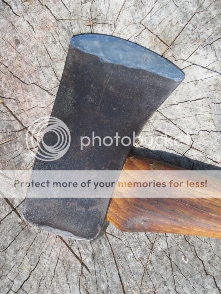

Filed, sharpened and peened.

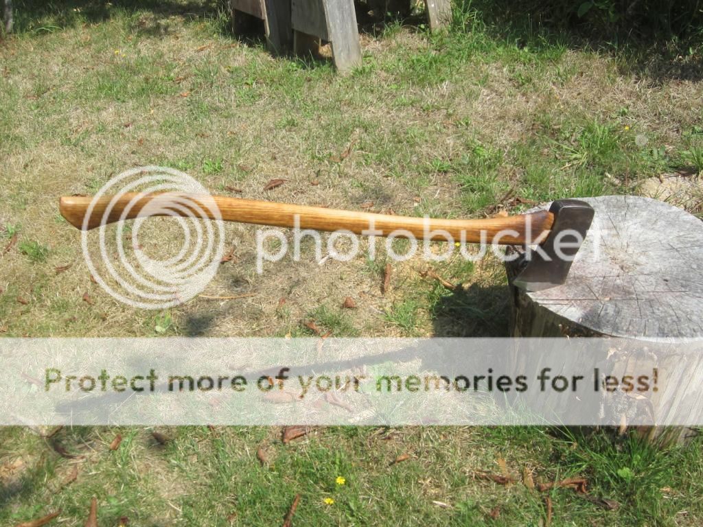

Overall I am quite happy with how it looks and feels right now. At 33.5" overall this is a nice single bit to add to my axe quiver.
And that is that.

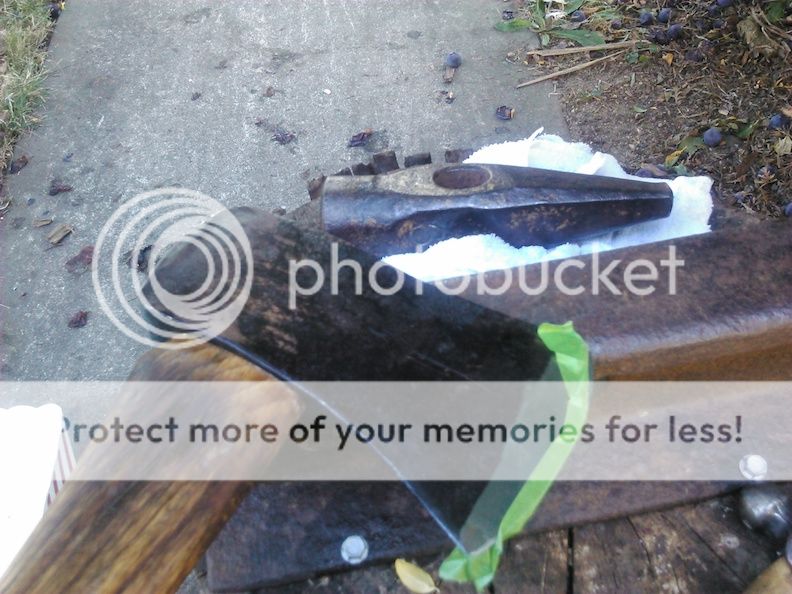

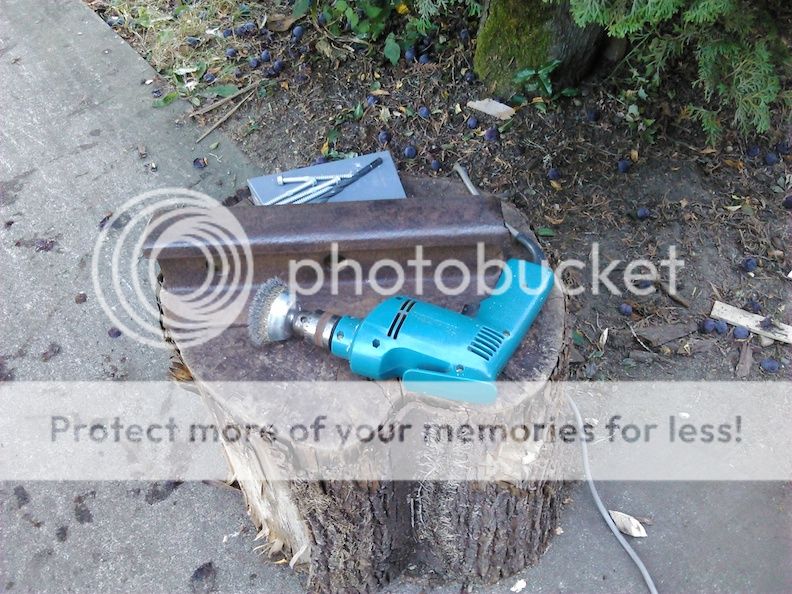

When you say peened what exactly do you mean? Also what did you do to get that finish on the head?
When I say "peened" I mean I use a peening hammer to pound the mushrooming flat. The technique I used was to wrap a cold, wet towel around the bit and heat up the pole with a propane torch. Then I layed it on a section of railroad track that I bolted to a stump as a makeshift anvil. I would use a ball peen hammer but mine is too small for this application so I used a 6# railroad spike hammer that has no handle as my peening hammer and proceeded to pound out the mushrooming. Heat, soak rag and wrap bit, pound, heat, soak rag and wrap bit, pound and repeat over and over. I took my time and kept the bit cool and probably really annoyed the neighbors.
I got the finish on the head simply by using the cupbrush in my power drill to take the red rust off the surface of the head while leaving that nice looking black rust patina.
Thanks! I never thought of doing this so I really appreciate your explanation. I really like how the patina on the head came out, did you use any vinegar or light oil like wd-40 on the head before or when you were running the cupbrush over it, the black just looks great. I have a piece of RR track like that now I just need to get my stump.

Nope, no vinegar or WD-40. Just the cupbrush. Vinegar will take that black patina off which I will do if the head warrants it (i.e. its really beat up and needs a lot of file work to clean up a lotof mushrooming, not necessarily just on the poll).
Peening without the mushroomed area red hot might not be ideal? I figured heating the area up till its too hot to touch would l make it a little easier to peen. Normally I would just file the mushrooming off but I wanted to play a little and am open to suggestions. Plus, I didn't want to file away anymore of whats left of the Collins portion of that stamp.

At forging temperature (bright red to orange) the metal will move back easily. But not all of us have a forge and you have to be really careful not to temper the bit when you're forging the poll. If you're lucky enough to have an induction forge then you can heat the poll while holding the bit in your hand. No chance of losing temper with that method.
Best reason of all not to grind the poll.
i agree with 300six that a propane torch isnt really doing anything on a 1" thick hunk of steel when it comes to peening it back into shape. it obviously wont hurt it, as long as you arent heating the bit itself. heating the poll with a propane torch im sure COULDNT transfer enough heat to the bit to draw the temper.
you would either, like mentioned, need a forge, or real torch(oxy/fuel) with the proper welding heads to get the steel hot enough to form it. you would be lucky to get the steel to more than a few hundred degrees with it being that thick and the heat being concentrated on such a small area.
