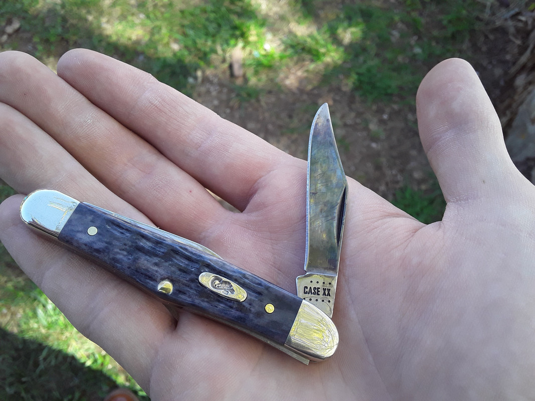

Thanks guys. A year ago, I never considered a patina knife blade.
Thanks for your response, but nope, have tried onion, garlic, leeks and only get rusty brown patine. Will try garlic
The best I know of is chicken, but heres a fresh blade after one granny Smith apple on Monday.
It gave me some blue, and the apple I ate yesterday gave me some more plus some reds purples and yellows.
