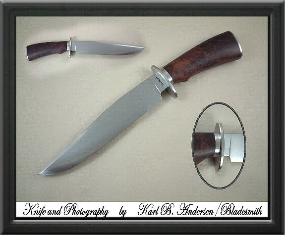

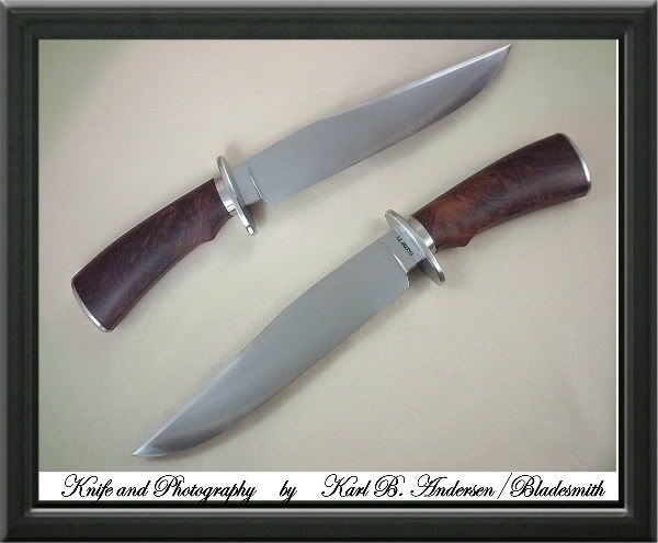

This handle material was fantastic! I'll be looking for more of this in the future.
Pretty basic clipped Bowie from Andersen Forge.

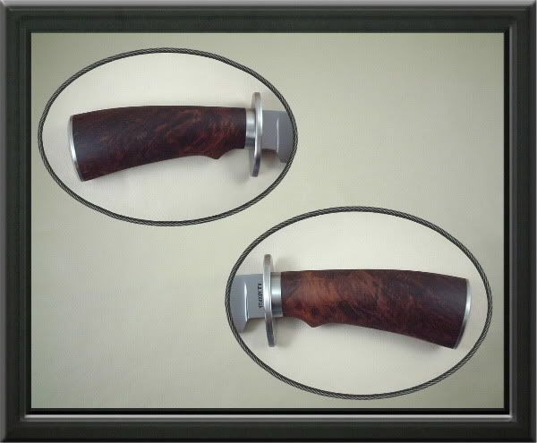

Beautiful red Mallee Root that I had stabilized.
Stainless fittings in a Take-down assembly. I minimized my normal "skull-crusher" pommel nut and made it flush-fitting to the faceted guard.
5160 forged down from really heavy stock.
7 7/8" blade and 13" overall
Thanks for letting me share!

Very nice piece Karl - you sure seem to have selected some particularly beautiful pieces of wood for the handles of your knives. Very good move, that. A really good looking knife overall.

Very nice as is everything you have been posting lately. The mallee root looks a lot like ironwood in the pictures.
