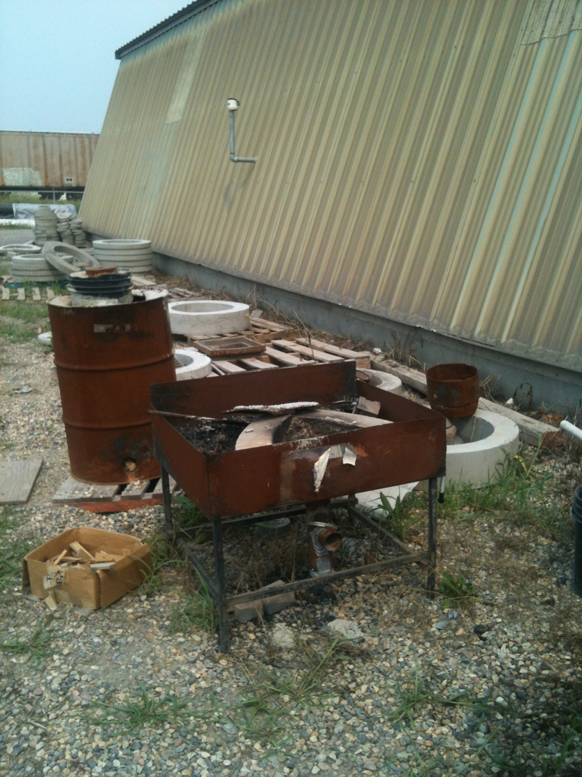

Now, my forge:
Those are old pic's, I quickly realized that steel plate with a concrete backing did nothing to keep the heat in, so instead I made a 1 and a half foot diameter round block to put over top.

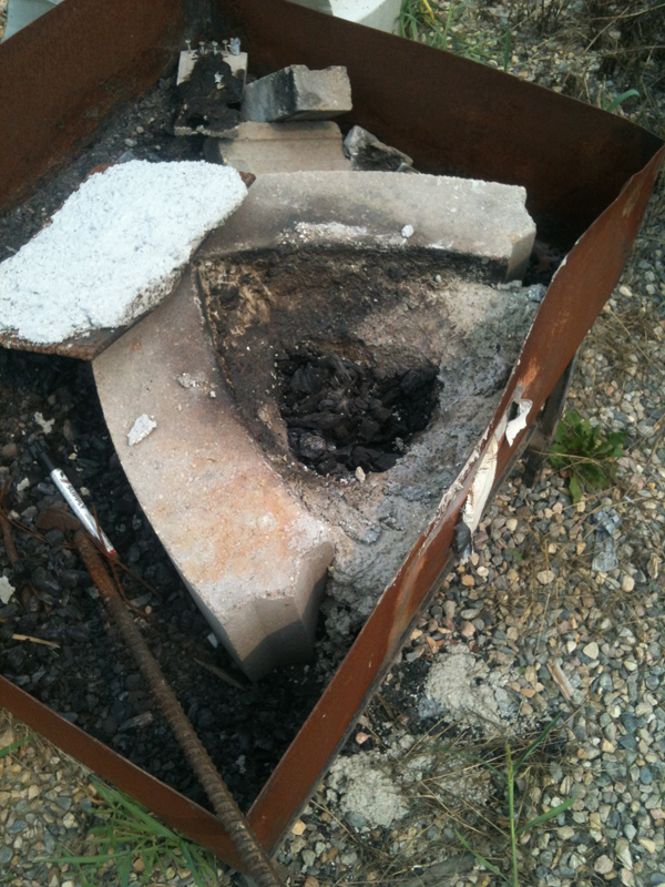

Anyways, I've already tore it apart a bit. I took everything out (except all the ash), and then pushed a much larger area clear of debris. Laid a firebrick in the back, and then 2 stacks of regular bricks along to the edge. So I have basically a 7 inch deep pit around my air inlet, and it' near a foot and a half in diameter... I packed the ash and old charcoal around the formation tightly, and poured some watery concrete along the edges to solidify it all, and now I suppose I have to build a bowl of concrete in there to contain it all.
I know I should use "refractory cement", but I went to home depot and they had tons of types of cement, but none that looked like any kind of furnace cement. I should note I make my cement mostly out of crushed up kitty litter, with some cement mix a bit of rock and some sand. I read somewhere once that kitty litter made a decent refractory cement, if that's true or not I do not know.
The forge is powered by a hair dryer which shoots air up the pipe below from a hole in the side. The bottom of the pipe has no cap, so I can pretty much regulate how much airflow there is to the fire by removing a few of the metal plates I stack ontop of the brick underneath the uncapped pipe.
So, yeah I want to make this into a coal burning forge which is capable of welding heat, I want to try some Damascus.
Any pointers you can give me? What obvious flaws are there in this plan?
