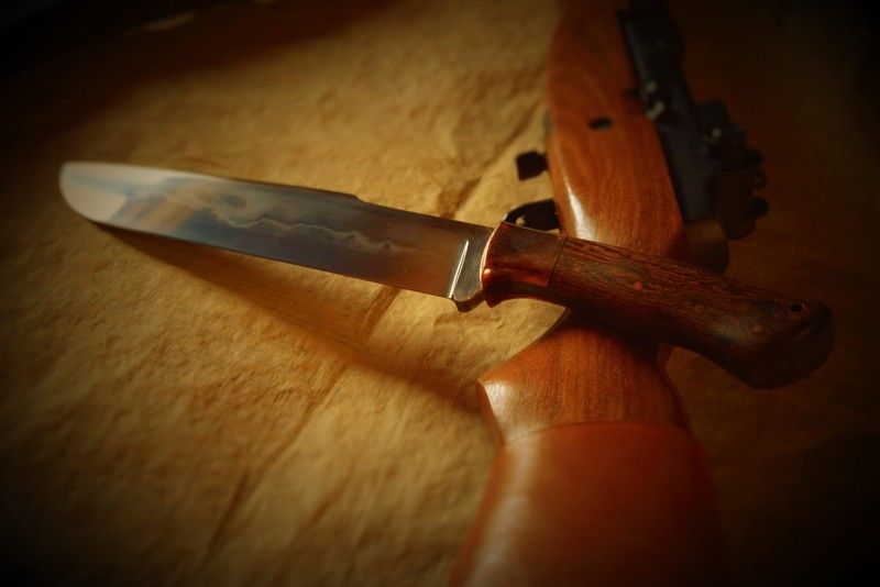

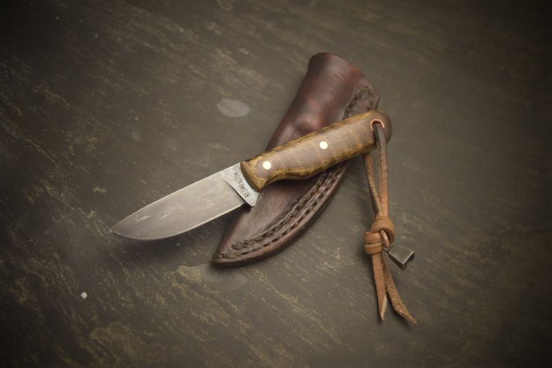

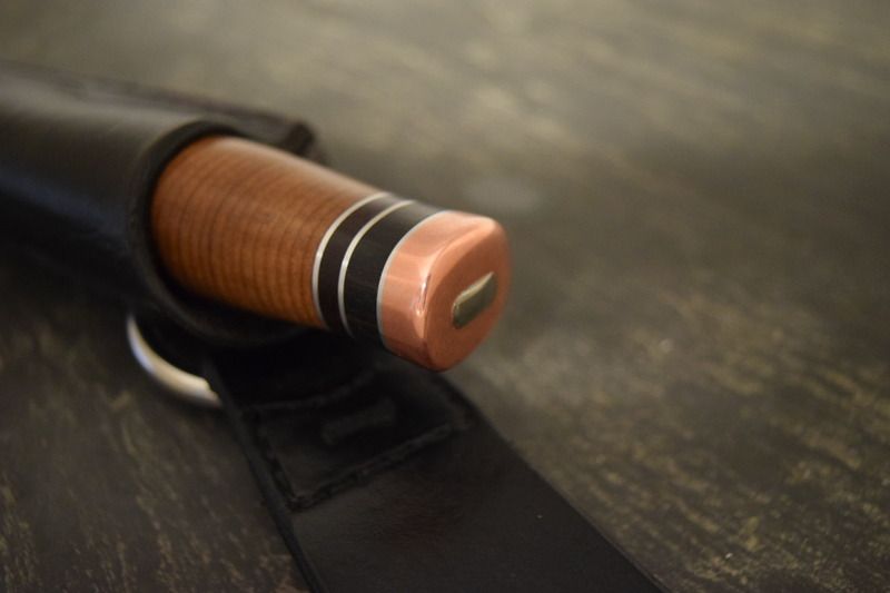

Some pictures of my work to start things off. I really enjoyed making the leather stack, we might see more of these.
Mainly carbon steels right now, 1095 and O1. I've been considering trying out some D2, possibly CPM.

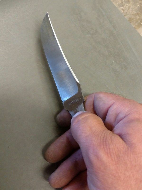

A skinner I'm working on. 4" edge, gonna be a leather stack with finger grooves. The finished grind will go a bit higher. A small swedge and a nice taper on 1/8" 1095.
I'll be out of the shop a good part of July, I'll throw up some updates when I get back and crackalackin.
That's looks great John, I hadn't seen that pic yet thanks for posting looking forward to seeing her finished!
Glad you like it so far Scott, if you get any ideas about spacer materials and whatnot let me know. I've got some bone linen and maroon micarta that might give a nice contrast.
I've got a similar styled blade with a much larger profile that I'm gonna be starting, with a leather stack/mule deer antler handle.

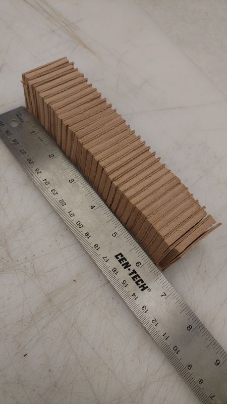

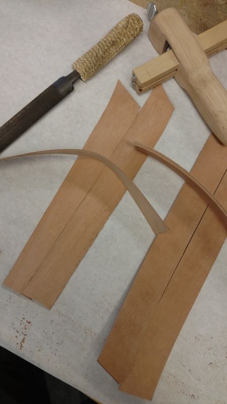

Glad to be back home. Cut up some leather for handle material. I'm gonna experiment with some 7-9oz and 3-4oz alternating. I'll get these cut down and punched, soak and compress them.
Let me know if you're down with the alternating thicknesses Scott. It might look interesting, if not we can always do them evenly.
While the blade is normalizing in the oven, I'll punch some holes for the tang and soak them.

The copper pommel looked awesome with the brown leather washers!
