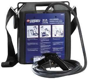

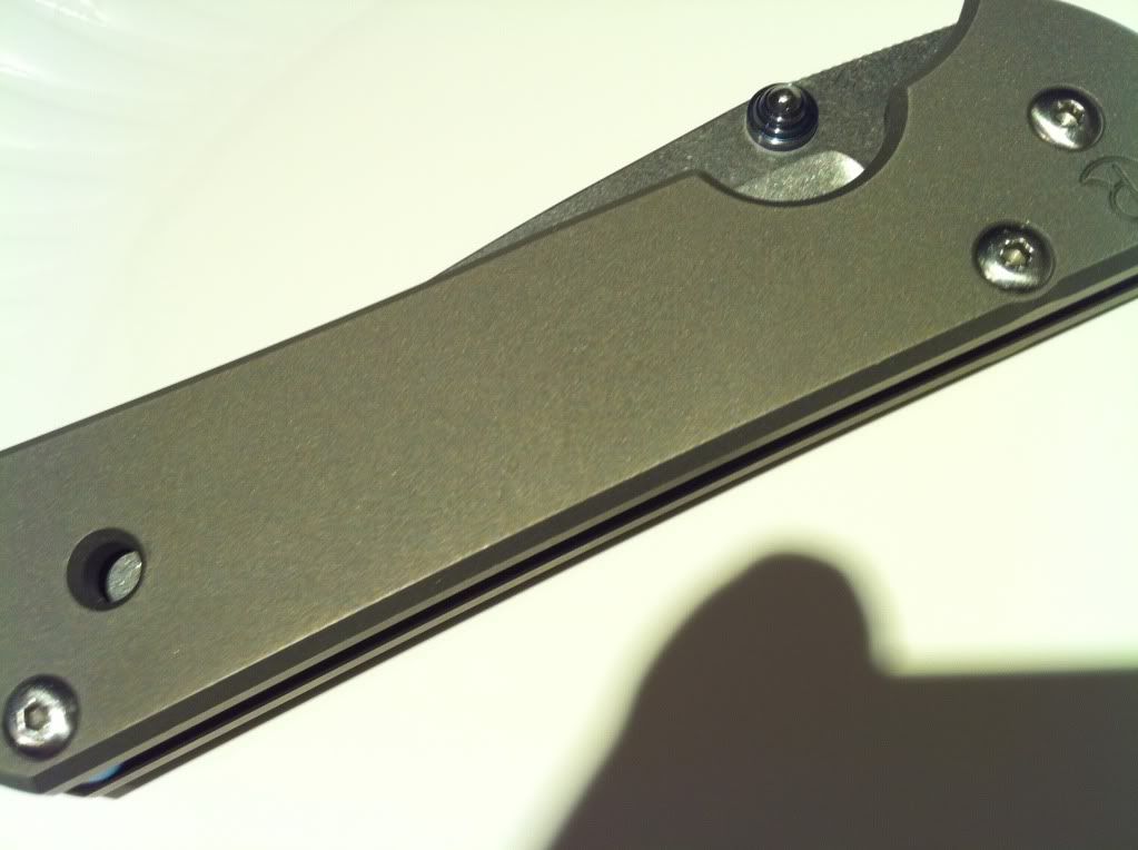

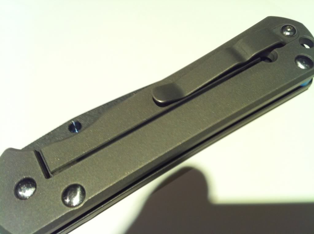

decided to refinish the slabs of my sebenza with a cheap harbor freight sand blaster!!! I i feel it came out great considering the whole setup is just around the same price as getting it done at the spa...
before
after
Excellent job, It looks brand new, Plus look at all the fun you had & no waiting for the mail man. :thumbup::thumbup::thumbup:

How did you go about protecting the lock face? That is one aspect I could never fihure out to protect if I were to do it myself. Looks great by the way!

mask it off with tape, same with the washer and bushing area.

Forgive my ignorance in this but when using a gun like this could it blow through the tape, or loosen it thereby causing damage? (so take extra care when taping!) Or does these type of guns not use that high compression?

The aluminum oxide blast looks closer to the factory. You can get AO at Harbor Freight.

hmm, I figured just use some paint masking tape. I think as long as it's on with no loose edges, it should withstand the blasting. I know Shane Sibert just uses electrical tape, and that stays on fine for him.
