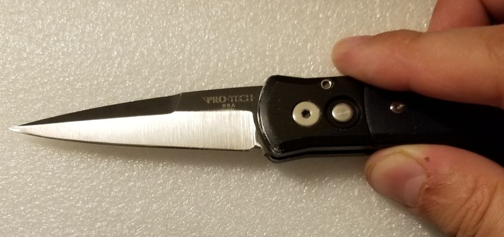

Yeah the regrind was to get the knife thinned out behind the edge. They cut so much better this way, as well as it being easier to sharpen a smaller bevel. I've done a few like this myself. Here's one of my very first attempts, a user-grade Pro-Tech. This one has been in my EDC rotation for about 10+ years.
