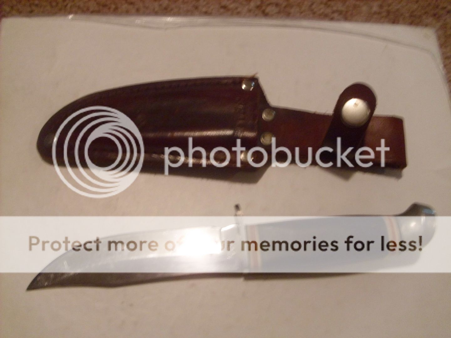

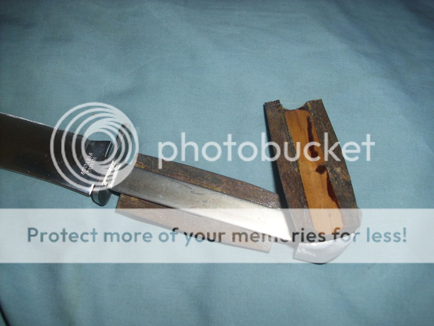

starting this project and could use some help.
the original way it was done was with a single piece of wood that had a hole drilled through the center, then cut down the middle, sandwiched and glued.
I would like to exnay the hardware and just put a wood handle on it. i have basic tools and LOADS of patience so if anyone could point me in the right direction that would be great! functionality trumps fashion in this, so as long as i can make it sturdy and comfortable i will be happy.
Thanks,
XM

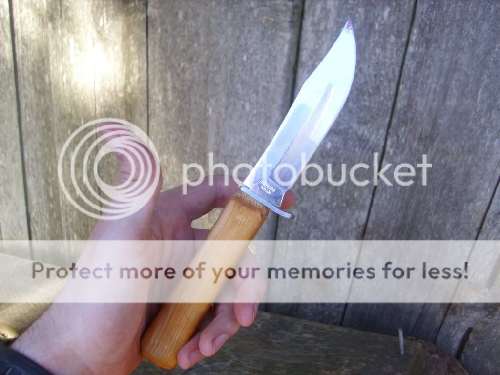

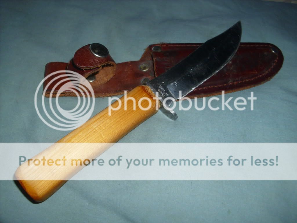

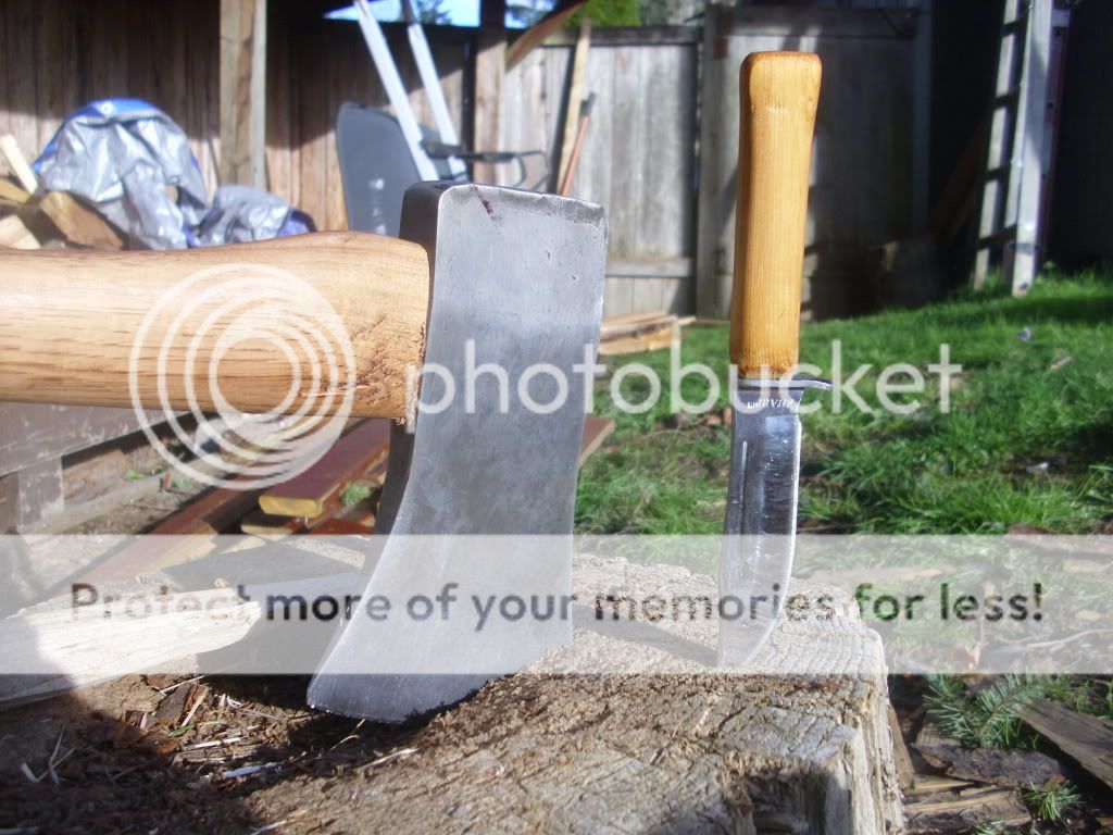

well here she is. not beautiful but its a fixed blade i can wear on my hip on hikes thats not so big that everyone thinks i am going to chop down a 90 year old tree.
thanks everyone for the help! if it holds up then this is how it will stay, but if it breaks i might get a bit more in intricate.
That actually looks very nice! I like it, much better looking then most of my ''first attempts'' turn out!
thanks! it is my first time ever doing wood work just by "eyeball" and "feel" i was used to working within a 32nd of an inch in high school. i was surprised by how it turned out considering my only tools were my leatherman charge, izula, 4in1 file, 100 grit sandpaper, and an old timer slip joint.
